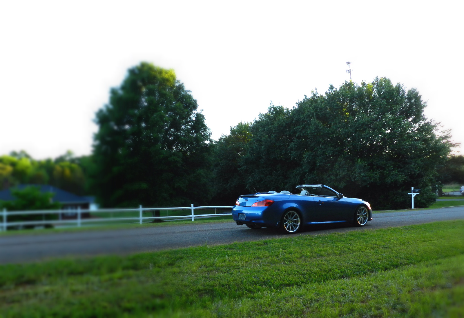

I've had my Eibach Springs for about 3 years. I'm happy with the drop and I found the handling did improve. I recently added Eibach front and rear sway bars and that resulted in a big handling improvement. I'd really like to install coilovers but it's not in the budget right now. The only problem, as I believe all lowered vert owners have experienced, is the rear camber/toe issue. I had the Eibach front camber kit installed but as far as I know, a rear camber kit is not available for the vert but if that's changed or if anyone has come up with a solution, please let me know. I also found, after installing the springs, that the wheels were recessed more than stock so I added front and rear spacers.

They don't make a rear camber arm setup, but you can still get your camber/toe adjusted to spec by using the SPC camber bolt/toe bolt kits. You need one kit (2 bolts) for the camber arm bolt, and another 2 bolt kit for the toe bolts. This will require elongating the bolt slots w/ a dremel tool, but not a bad job. The kits are about $25 each. Quite a few vert owners w/ lowered Gs have gone this route and it works well.

Yep, what Brad said, you'll need 4 bolts and you'll get yourself in spec. Verts are pretty low from factory so unless you are scraping the ground, the drop isn't all that drastic and it's relatively easy to adjust.

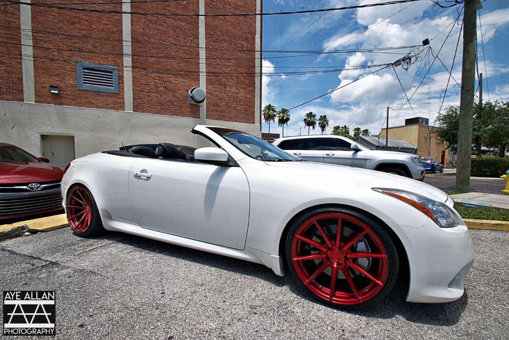

My first post. Still got a long way to go. <br/>#Rohana #RohanaRF1 #RohanaWheels #20x10 #20x11 #D2 #D2Coilvers #TruHart #TruHartCamberKit

Camber kit - front or rear? Link?
What springs do you have on d2s? Any issues with the COs themselves?
What are the offsets on the wheels? Spacers in the back?
Rubbing anywhere? Shaved rear bumper brackets?
This picture is pretty awful though. Can you post the original one? All that 'shopping is taking away from the true beauty of your car.

my bad on the delay. Yes front and rear camber but not adjusted yet. Yes d2 springs. Off sets +25 & +28. No spacers. No rubbing. No shaved rear bumper bracket. Sorry for the pic, I wanted to see what the wheels would like bright.
Thanks for the response!
What are the specs for d2 springs? Stock convertible ones? 8.7 rear?
What setting (clicks) are your coilovers at?
Did you have truhart make you a custom kit? Would you happen to have a part number?
Since you have some unique parts I'm trying to figure out what all the settings are so we can document it and have it available for others.
my boys shop order them for me. I actually got my wheels three weeks before I got my co. They took about four weeks to come in. I'll look to see for the part nunber. The settings is off since they wanted my suspension to be soft. But it bounces too much. I'm just too busy with work to go in to adjustive. Unfortunately we've been talking to Rohana since my front wheels don't match the color of the rears. Once I fix my issue with Rohana, I'll fix the setting on the co, and finally on the camber.
