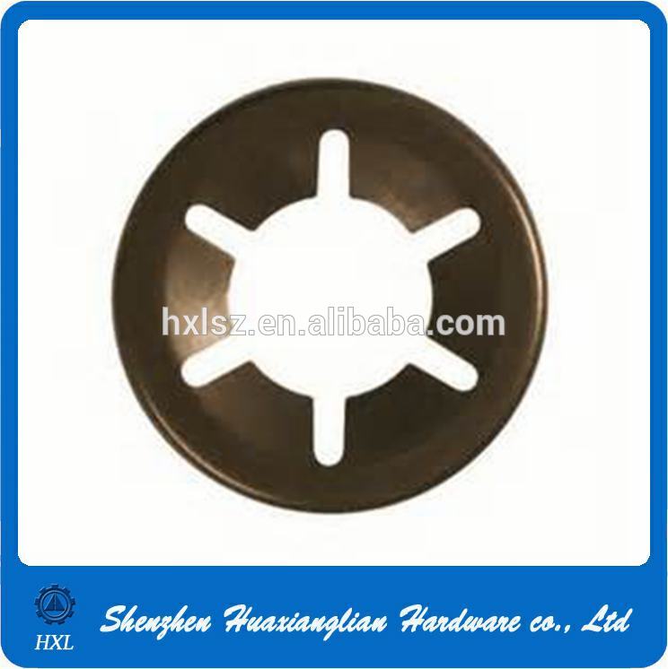

I've picked up some "Retaining Washers" or "Push Nut" from a local hardware store and I'm going to see if that will help with the mounting screws. By using these washers I can put the two M6 screws through the bracket and then press on the washer from the opposite side. They will keep the screws from falling out as I position the bracket. I'm going to just install the washers just far enougn onto the screws so that they will retain them to start with. once I have both screws started into the nuts within the inner fender, the washers will be pushed all of the way to the bracked as I tighten the screws down. Well.... that's my plan. I'll attach a photo of the type of washer I'm planning to use to help anyone who isn't sure of what I'm talking about.
Attached Thumbnails Z1 Motorsports Brake Master Cylinder Brace-china-push-nut-bearing-clip-retainer-washer.jpg

I've picked up some "Retaining Washers" from a local hardware store and I'm going to see if that will help with the mounting screws. By using these washers I can put the two M6 screws through the bracket and then press on the washer from the opposite side. They will keep the screws from falling out as I position the bracket. I'm going to just install the washers just far enougn onto the screws so that they will retain them to start with. once I have both screws started into the nuts within the inner fender, the washers will be pushed all of the way to the bracked as I tighten the screws down. Well.... that's my plan. I'll attach a photo of the type of washer I'm planning to use to help anyone who isn't sure of what I'm talking about.
I used a small amount of blue painters tape to hold the nut onto the driver.
Make sure it's assembled correctly before you install it. Mine was orientated backwards....which I didn't realize until AFTER I mounted it
