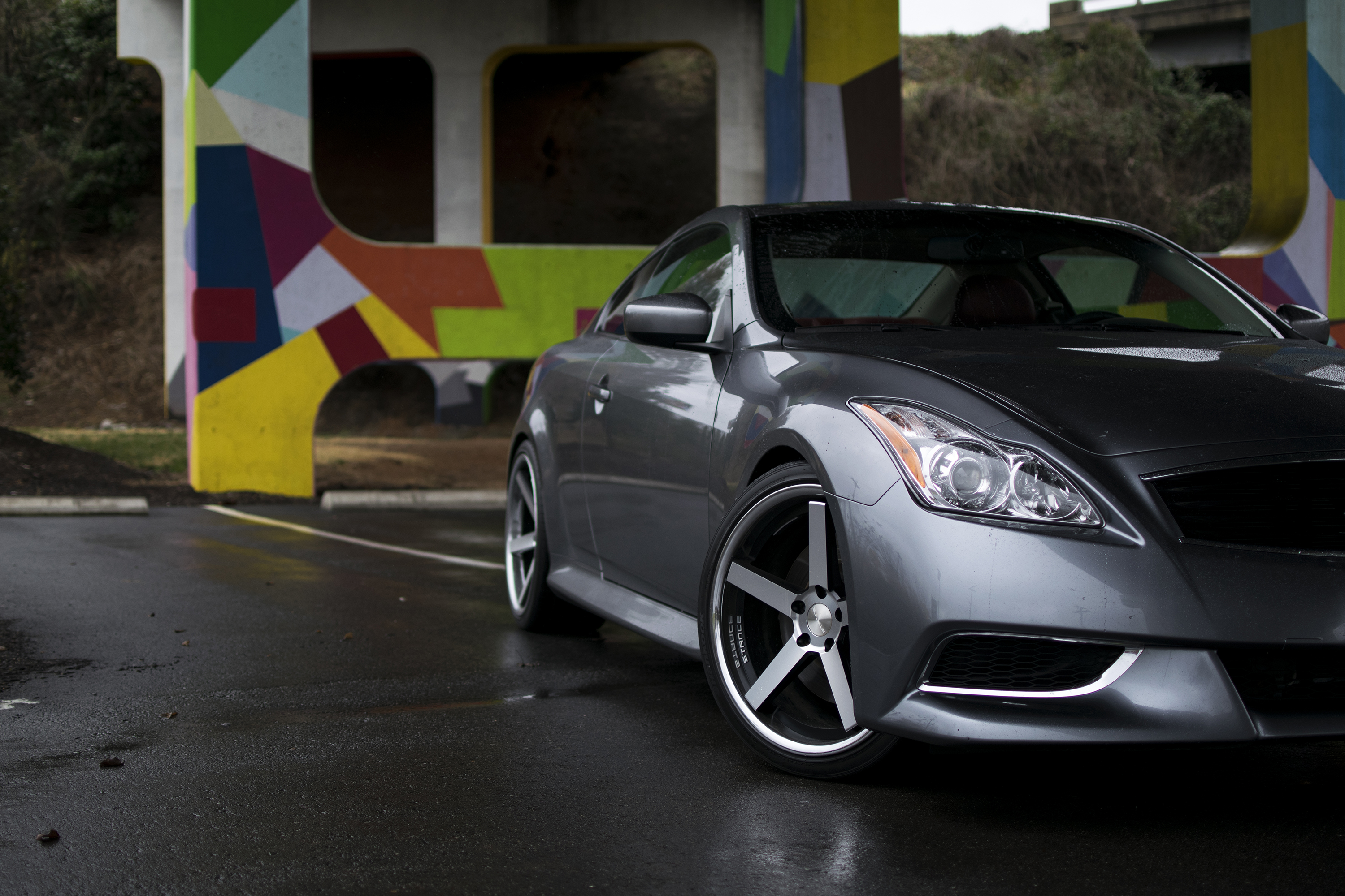

My 2010 g37s anniversary edition was lowered with Eibach Pro-Kit lowering springs, and Stillen sway bars back in 2010. About a month later the car started making a popping/rattling noise on the drivers side every time I would go over the slightest bump in the road. It is getting so annoying and we finally took it to get it fixed. With the car in the air it was clear that the front Stillen sway bar was hitting my lower control arm and grinding it down. Anyone ever have this issue? Know how to fix it? Also I get a squeak sometimes as well. One guy that looked at it said it's the upper strut mount... The other guy said my sway bar bushings could be the blame. Thoughts?
