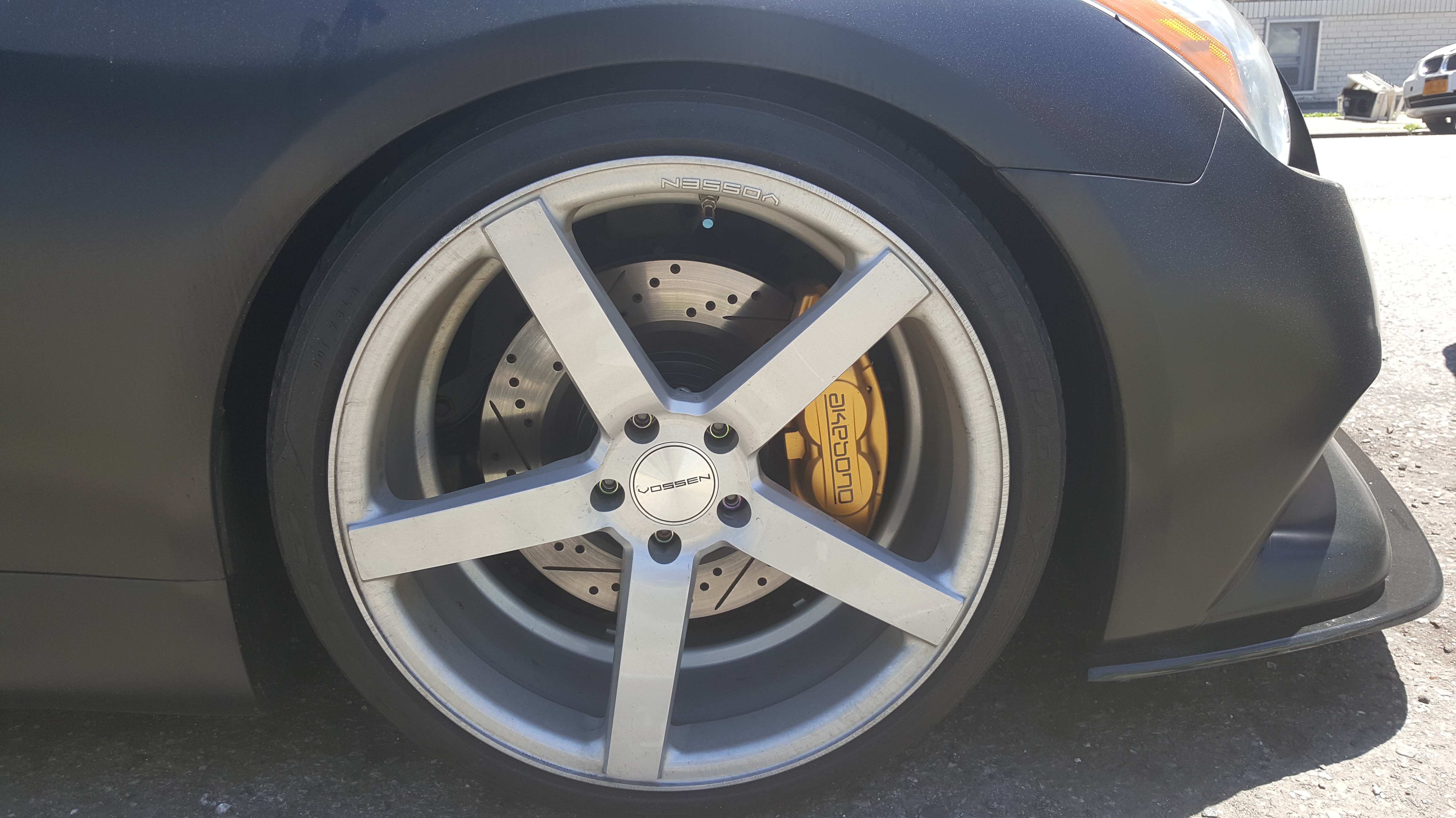

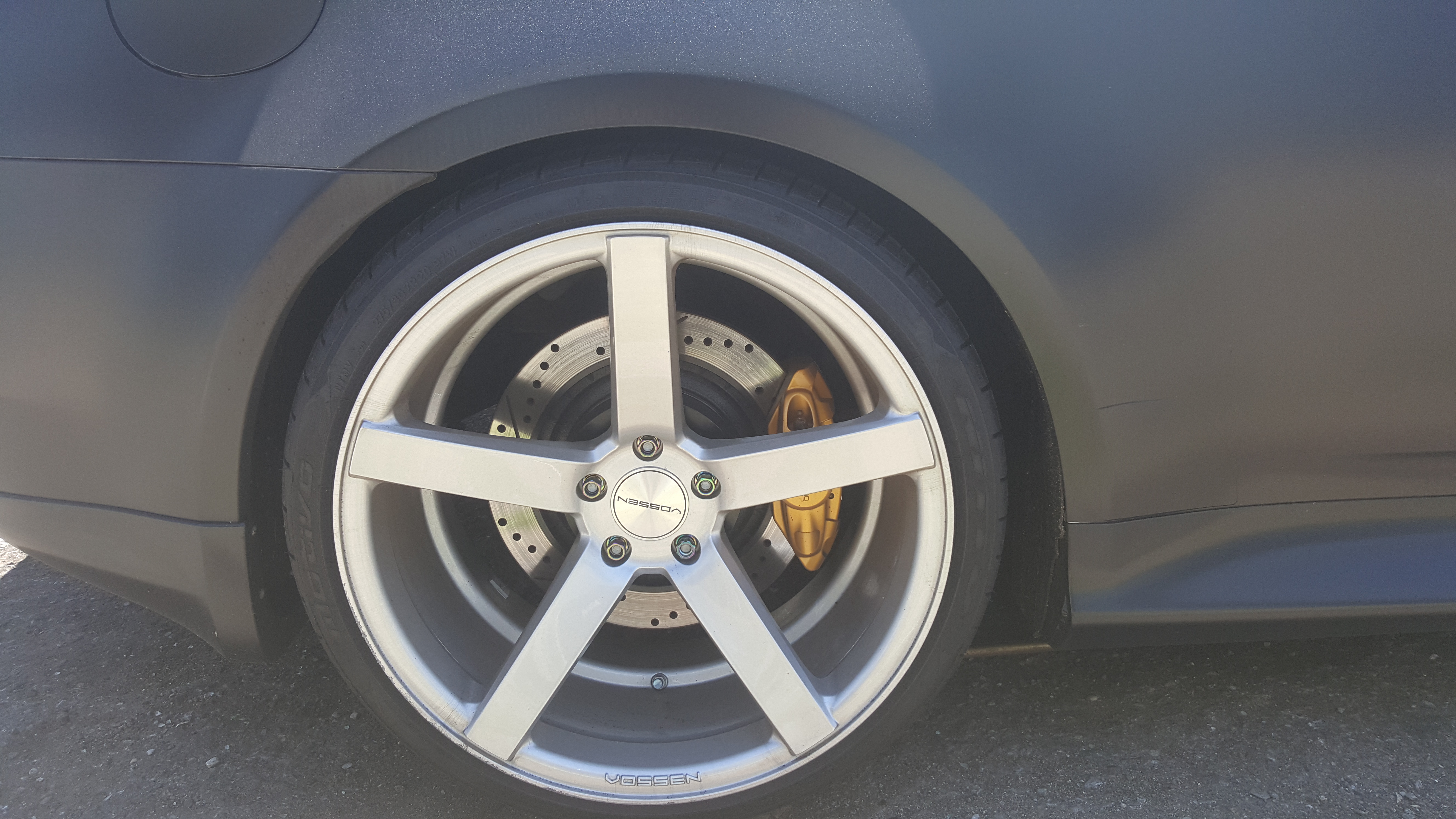

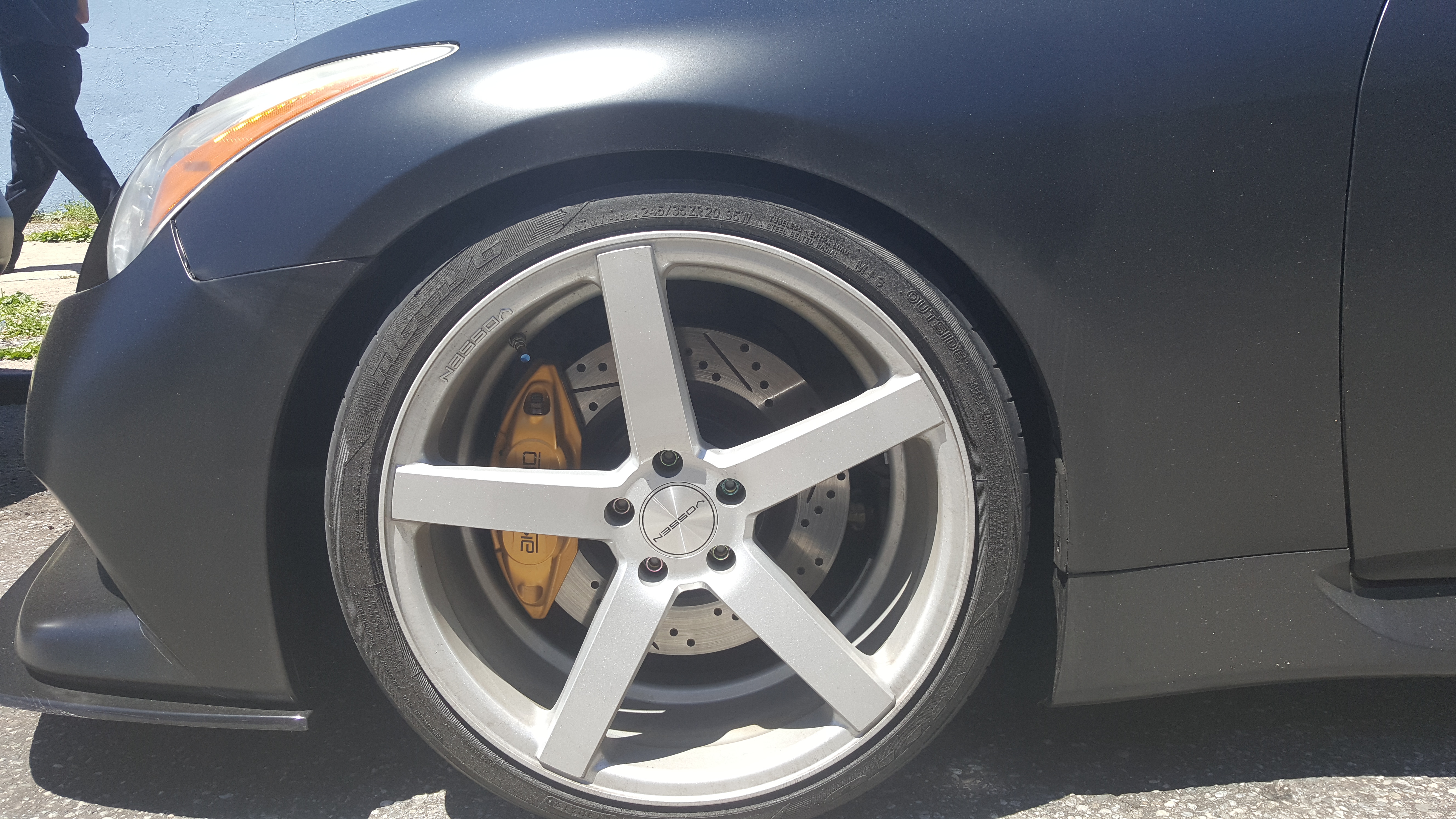

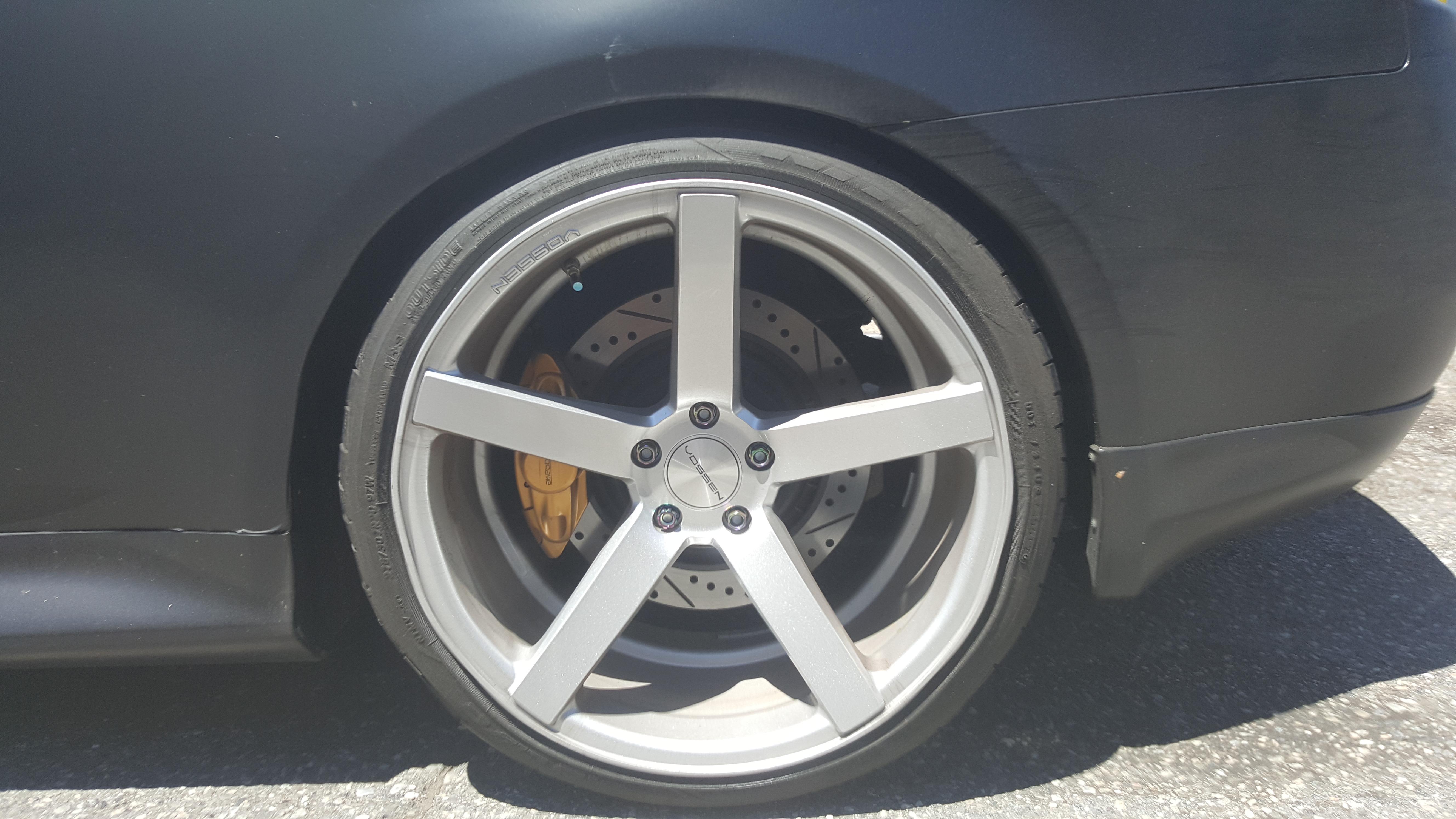

I have the Eibach Pro Kit on my X coupe and don't think it's low enough. I love in NJ and the weather especially snow is pretty bad but I've lasted 2 winters so far without any issues at all.
Here's some close up pictures of my drop to compare what yours will look like on all 4 sides on an awd coupe.
Attached Thumbnails NEWBIE Q: suspension height G37 coupe RWD vs. AWD-20160610_122928.jpg   NEWBIE Q: suspension height G37 coupe RWD vs. AWD-20160610_122938.jpg   NEWBIE Q: suspension height G37 coupe RWD vs. AWD-20160610_122952.jpg   NEWBIE Q: suspension height G37 coupe RWD vs. AWD-20160610_123001.jpg

Thanks! Good pics for reference! How many finger spaces is that? 1?
Did you have a to buy a camber kit? I'm guessing alignment is a must?
How is the day to day driving?
Old Jun 14, 2016 | 01:34 AM
Day driving is great I think it's A LOT better than the stock feel for sure. It's about an estimated finger space and as for camber kits you might want a rear camber kit only to be safe.
I personally have had these springs for about 2 years now without a camber kit but I got a new set of wheels and tires and noticed a little camber wear on my old set but they lasted a pretty good while.
