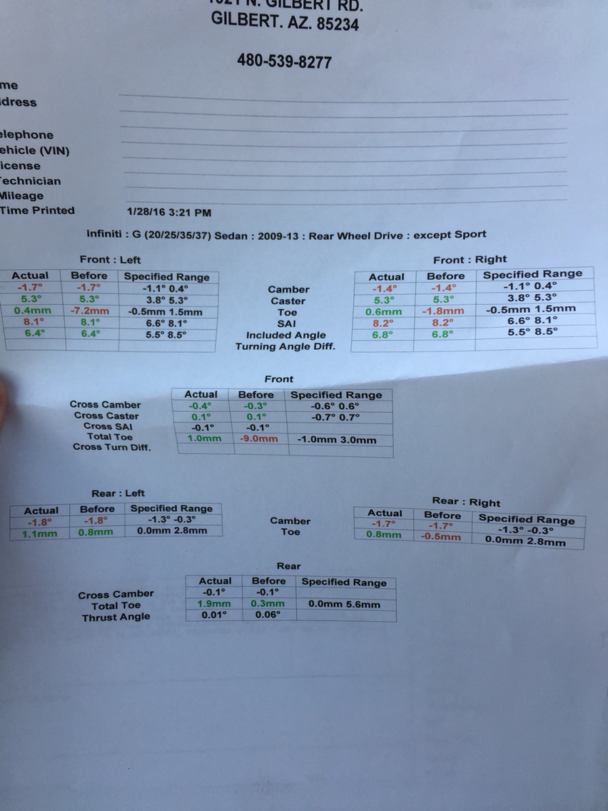

I have swift springs and all my toe is in spec and camber at around negative 1.7 or so. I would say go to a better place to get the aligment! I'm RWD but still I don't think it matters much. no camber kits or toe bolts

My guy just told me my total toe was 10 mm and then asked me what I wanted. I just shrugged as I didn't think of toe in millimeters. He suggested 5 and that's where I am. The car sure turns easier. With almost 12k miles on the tires since the alignment, I'll have to check for asymmetric wear.
The above chart says I'm at 38 minutes of a degree, meaning about 0.6º total toe-in.

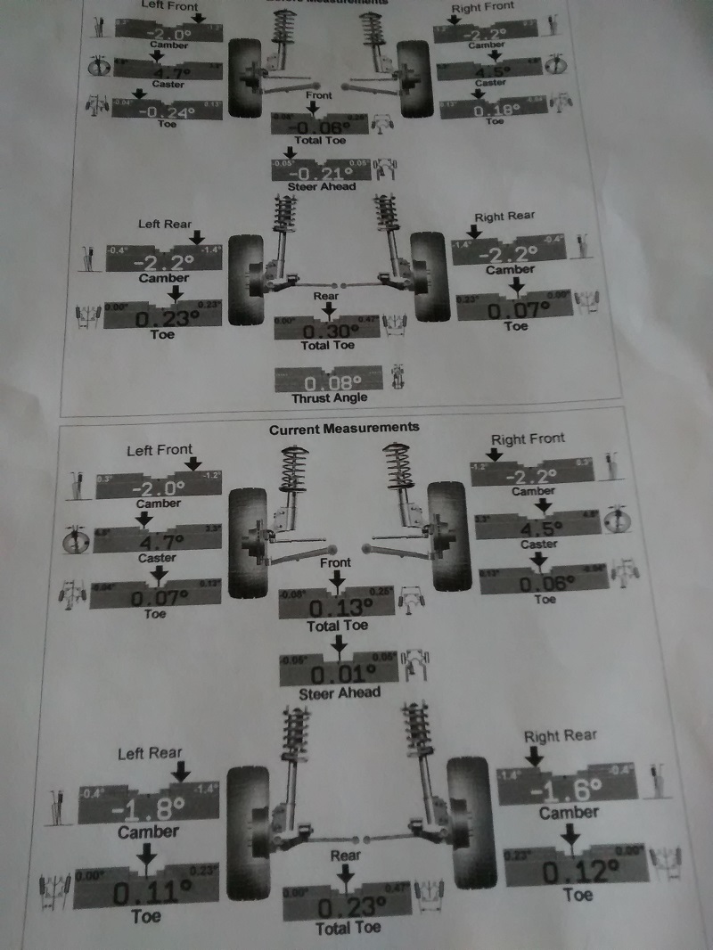

Hey guys, just also got my alignment done too with swift installed on a g37x sedan. since i'm not so sure how to read the specs, could anyone tell me if it's good enough to not warrant a camber/toe kit? im running on 17's for now until next week when i plan on getting my 19s on. thanks!

You should be ok w/ that alignment set, keep an eye on your inner tread wear over the next 5k miles, I doubt you'll have excessive wear though.

Interesting. I got a camber toe kit, haven't installed it yet, but since you got into specish numbers, maybe i'll forgo it... Toe is all I'm really worried about. My alignment is scheduled for Sunday.
