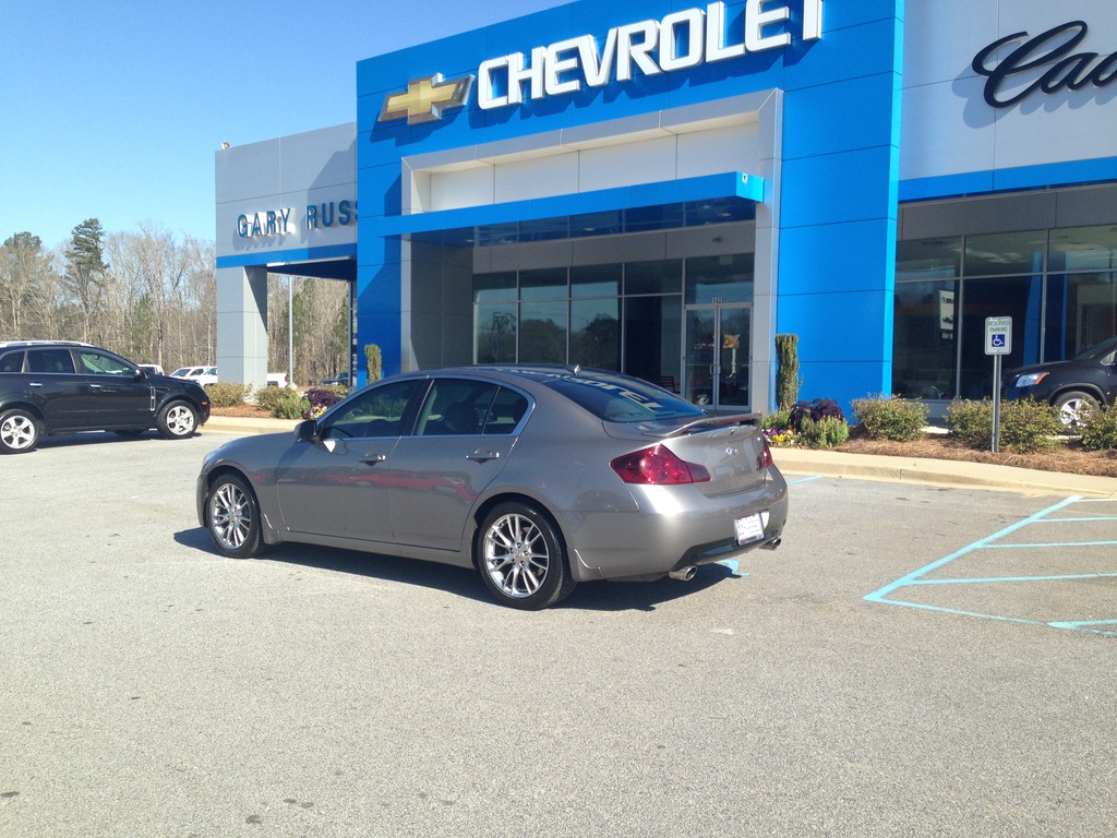

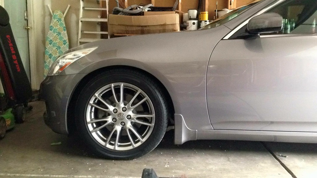

Hey guys. I've been lurking here for a while learning things about my 2008 G35. I got some OEM 03-05 350z coupe springs a while back off Ebay for $60 shipped for the set. Not sure if these would even fit because i haven't seen anything about these springs on the 07+sedans I was hesitant to install. Well with the motivation from my buddy 35Sport i went ahead and installed them. I am very pleased with the results and highly recommend them if you want a drop but don't want coil overs or want to alter the cars ride and just want a mild drop like I did. The rear has a 1 finger gap and the front has a 2 finger gap. Camber arms and some spacers will help out back there also. But the ride quality has not changed at all. I only noticed it corners flat now but its not harsh or anything. I just felt the need to pass on the my finding to my G buddy's. Here's some pictures of 03-05 OEM 350z coupe springs on my 2008 Sedan. And not lowering springs just the stock 350z springs.
This is a before just showing how my car sat originally.

And the following is how the car sits now.

Next on the list are Camber arms for the rear and some spacers all around and a Lip.

I knew they'd work since I had the eibach 350Z springs on mine. Surprised at how well it worked out though. Most Z guys will give away their old springs.
Old Mar 27, 2016 | 12:09 AM
Not bad at all. Only caveat would be for G37 Sedan owners w/ the 7AT, it will drop a bit more in front on those since the 7AT weighs about 140 lbs. over the 5AT.
