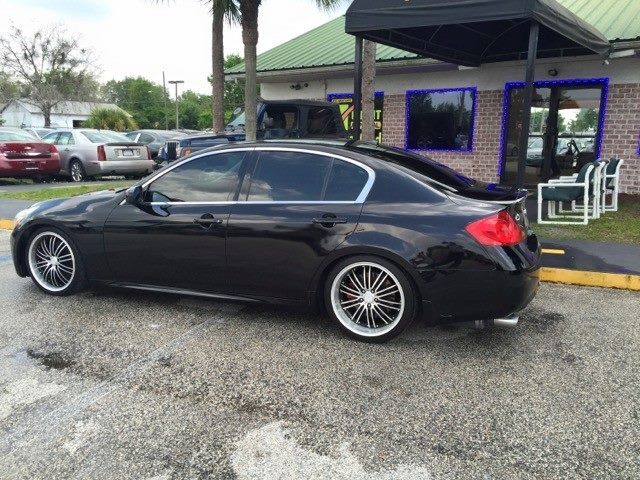

When I bought my G, it was sitting very low. It had an Eibach kit on staggered 235/35f, 255/35r rims and stock struts. It scraped on almost every speed bump unless going .5 mph and even then sometimes, no luck.
It was something like 25.5" to the top of the wheel well on all 4 corners. No rubbing in any well, but alot of bottoming out. I coulda just gone with better struts but I desperately wanted some height and adjustability. I chose BC Racing(bonus that their headquarteted in my home state).

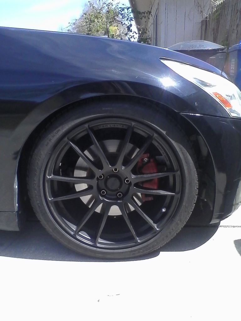

In the meantime, I developed a crack in one of my rims and decided to replace all 4 in lieu of repairing and then refinishing the damaged one. I found a stupid good deal on a set of like new satin black 19" Rays Gramlights. The rims are wider than the old DC's and fit alot more flush and the tire sizes were identical in the front but a 265/30 in the rear which was a bit of a blessing given what was about to happen with the suspension.

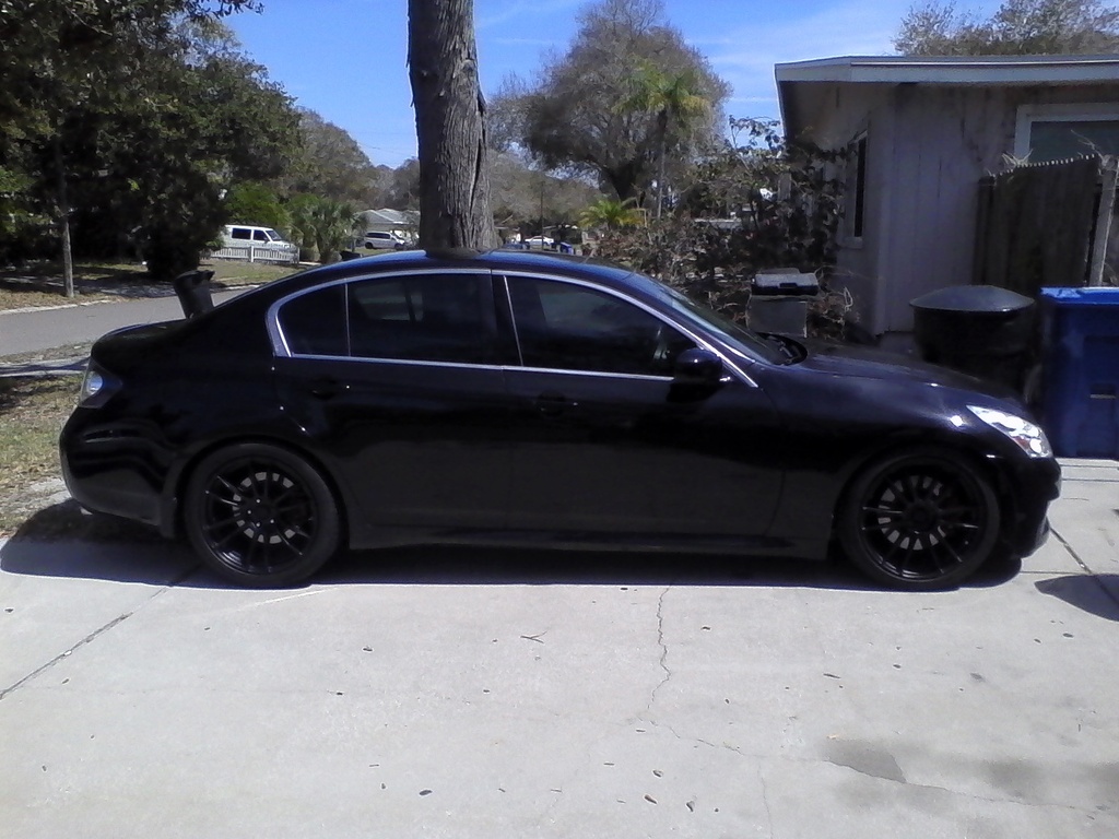

The thin tires were still a nuisance. So I had to get the rear end of the ground. A quick call to BC Racing in Orlando( Thanks Al), and I had a set of 255mm 8k springs to replace the 210mm springs that came with the 370z kit. Replacing the springs was a snap and now, she was ready for a new pair of soles. I wrapped the 19" Rays with Pirelli Pzero 245/40 in the front and 265/40 in the rear. She's sitting at 27" to the fender well in the rear and 26.25" in the front. She rides like a dream, and can even get a little bit softer or harder if I need her to. This was by far the best investment in my G yet. It's a night and day difference and worth every penny and bead of sweat.

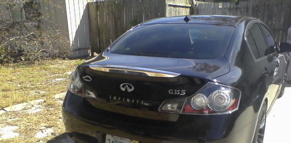

And just to add a little flavor for others to enjoy while watching me drive by, I put on a clean set of clear lens taillights in a black housing.

Nice to see your G is back to a better height for daily driving and good to hear BC set you up w/ the proper spring sets. Not sure what to say about the clear tails though, but hey, if you like them then who cares right

I know the tails aren't for everyone, I just wanted to get rid of the big red blob of the OEM taillight. That blue is fn gorgeous.... And my favorite color to begin with. It would look sick with the black f rims too. Thx
