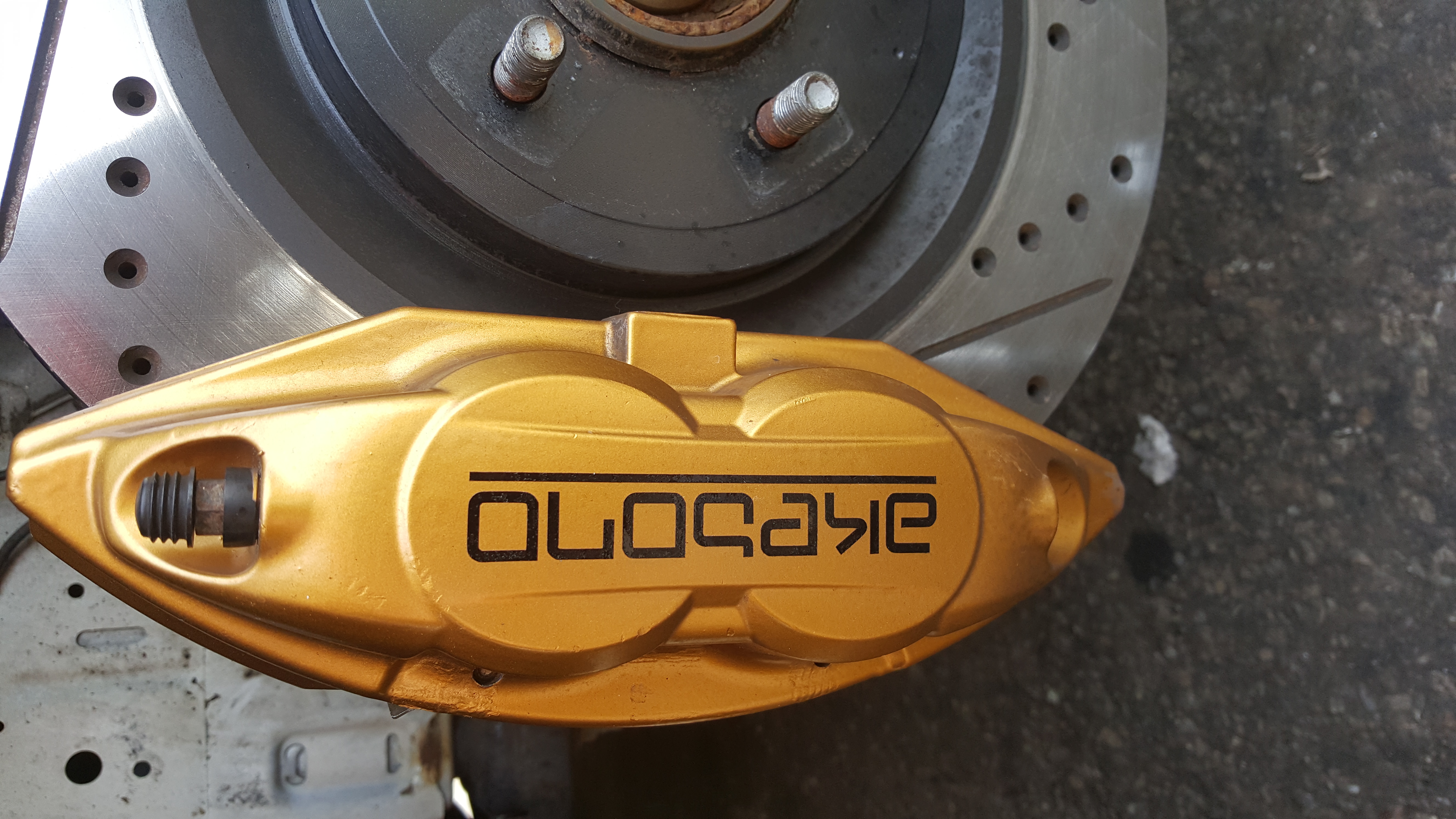

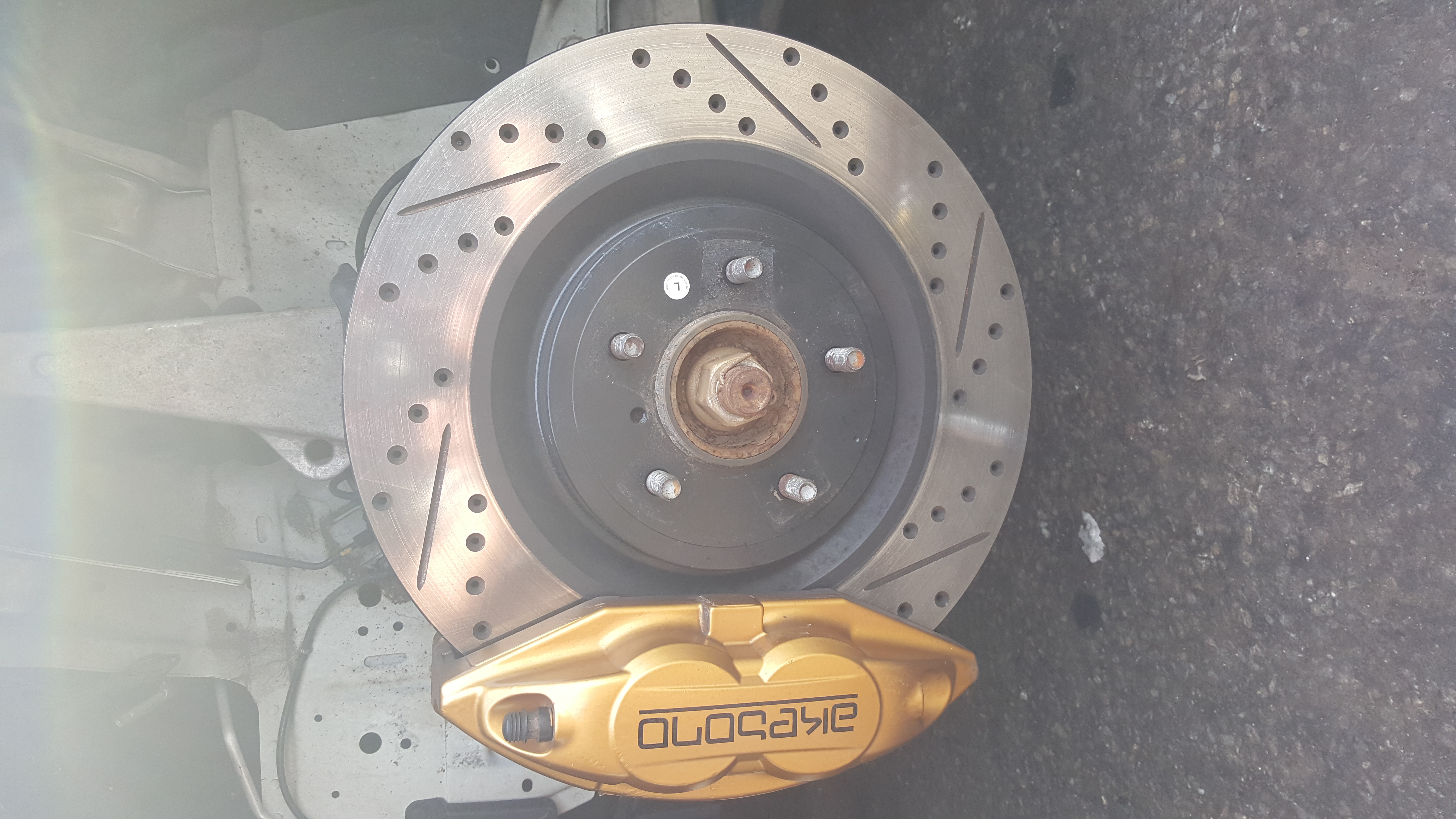

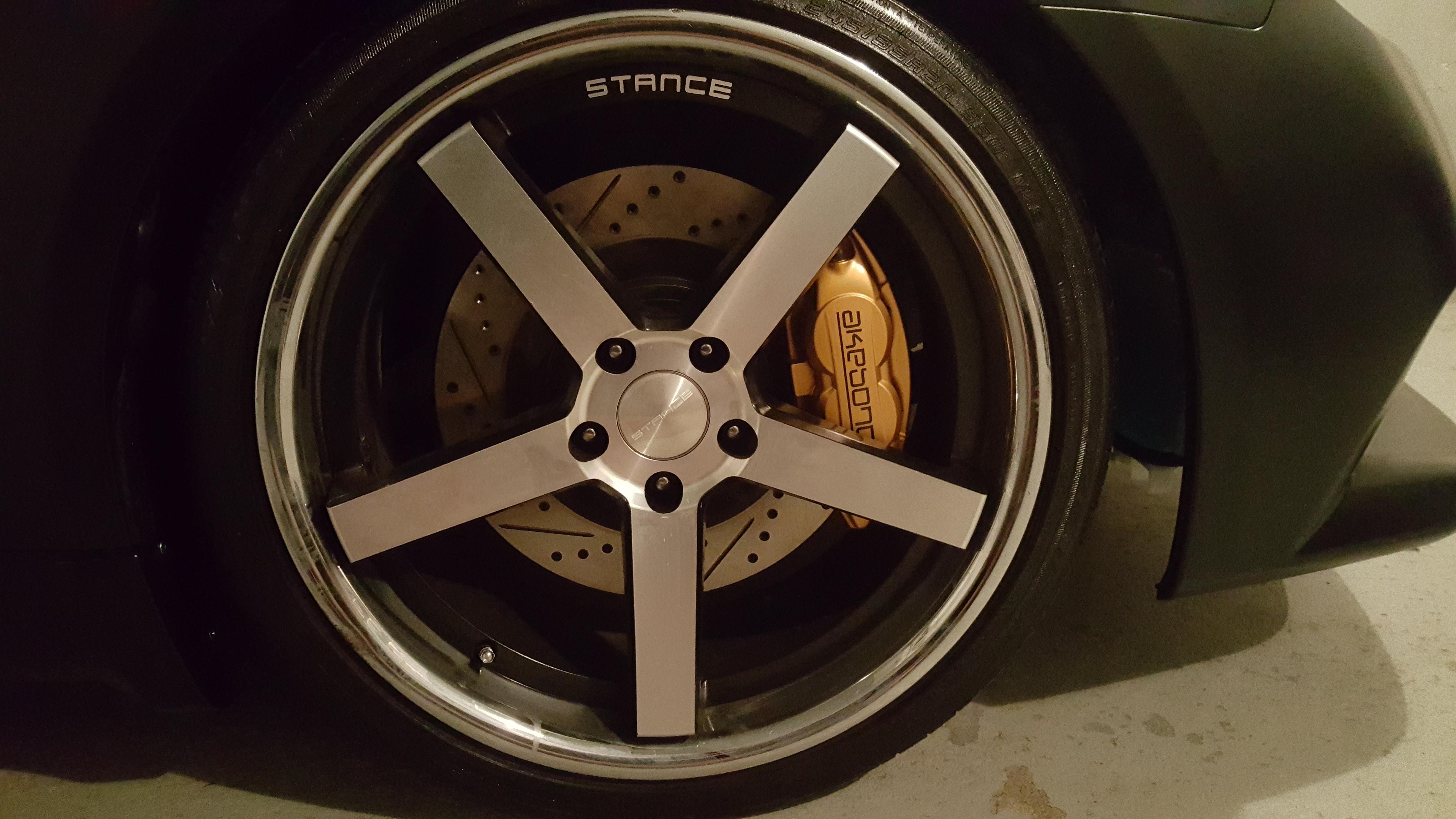

Did my stoptech drilled&slotted rotors and duralast ceramic pads myself and decided to have my friend paint my calipers while I was at it bc he's good with paint and I absolutely love how they turned out!
Attached Thumbnails New Pads or New Rotors?-20160316_133408.jpg   New Pads or New Rotors?-20160316_133402.jpg   New Pads or New Rotors?-20160307_222320.jpg
