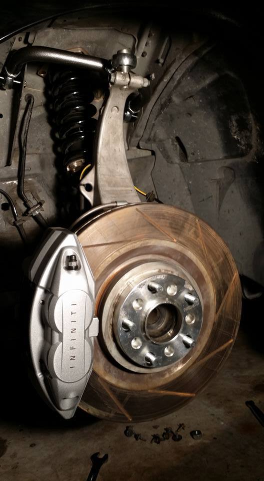

I personally wouldn't use a spherical rod end ball joint like on the Z1 for the street myself. Way too many bumps to torture one to premature failure for me. Plus there isn't any boot or grease, nothing to make this thing last. It is however fairly easy to replace and obtain probably.

Originally Posted by jfisher
Exactly. They "should" be locktight'd together, but mine were not and started backing off over time. Made all kinds of noise. I believe it's a 6mm allen up top and I can't remember the size of the bottom half of the ball joint, but it's actually a standard wrench on the bottom. A 19mm wrench held, but it was whatever the standard size is, down.
Well it turns out you were right. The passenger side started coming loose and making a lot of noise. Sounded like my strut wasn't tightened down. I backed the bolt out, squirted red locktight in there and tightened it back down with an 8mm allen wrench. Now I'm enjoying no noise and I can drive it how I intended I was going to be able to.

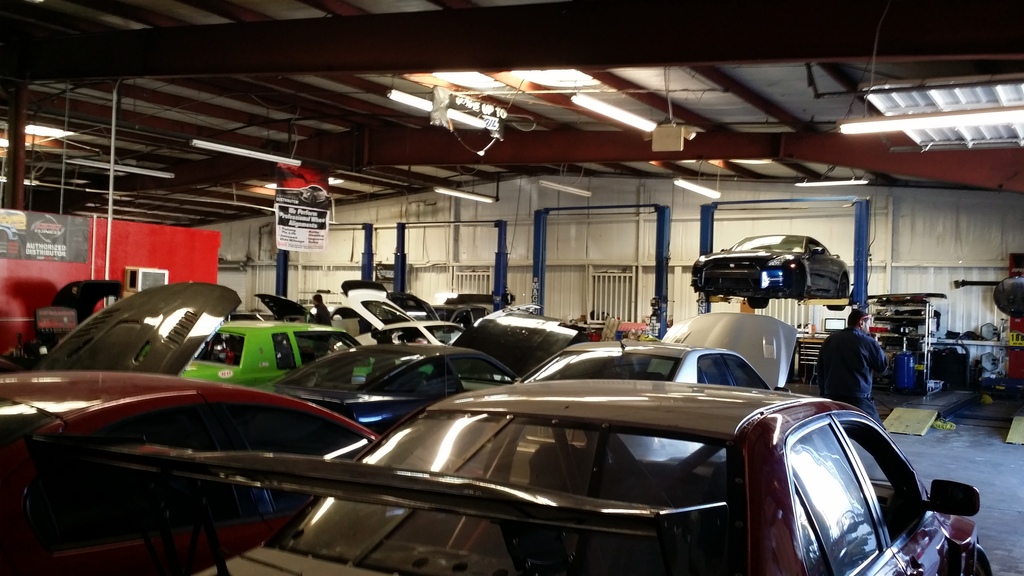

Yeah that was me. I always rev at Zs and Gs as my way of saying hello. Nice G, you have there. I installed the arms myself and brought them originally to PRS in Sanford where they proceeded to try and rip me off by doing nothing and charging me for an alignment. I eventually ended up bringing it to Nissan in Deland as they have a GTR tech there named Derrick who's into Zs and racing. He knows his stuff and always takes care of me when I've been in there.

Originally Posted by 35Sport
Actually everything you said about the Z1 arms is incorrect.
The rear adjustments MUST be adjusted equally according to the installation instructions or major damage could occur!
I was reading through the installation instructions of the SPL arms today and came across this:
"To adjust caster, lengthen or shorten one adjuster at a time. For more caster shorten the adjuster towards the rear
of the vehicle or lengthen the adjuster towards the front of the vehicle. For less caster lengthen the adjuster
towards the rear of the vehicle or shorten the adjuster towards the front of the vehicle. Please refer to the hybrid
adjuster instructions below."
http://www.splparts.com/content/SPLFUAZ34.pdf
I know Z1 isn't SPL, but Z1's instructions over the phone to make caster adjustments are exactly that of SPL's instructions although the overall design and adjustment isn't exactly the same. I was debating on getting rid of my Z1's and saving up for the SPL's, but I'll just stick with my Z1's. I'm going to be pulling them off to regrease and re-lock tight the balljoints together. I'm getting some bushing to body noise when going over speed bumps very slowly.
So I finally bought some Z1 front upper control arms (race spec) to address my camber issue up front. I grabbed some 20mm spacers and extended studs from them as well.
Installed extended studs, front upper control arm and the 20mm spacer.
Attachment 135455
Before:
Attachment 135456
After:
Attachment 135457
Attachment 135458
Got it aligned today...
Attachment 135459
Much better
Hey bro, I bought some z1 upper control arms and put them in myself. Went to go and get them aligned at fire stone they couldn't do it... they were telling me that they would have to take out the upper control arm to adjust the caster and camber since it was off. So is that true? Asking for help thanks. Oh! Have a 08 g37s coupe 😁
Yes that is true.
