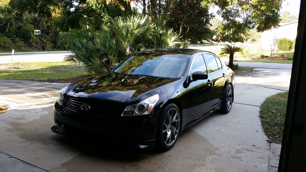

So I finally bought some Z1 front upper control arms (race spec) to address my camber issue up front. I grabbed some 20mm spacers and extended studs from them as well.
Installed extended studs, front upper control arm and the 20mm spacer.

Before:

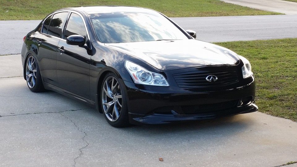

After:

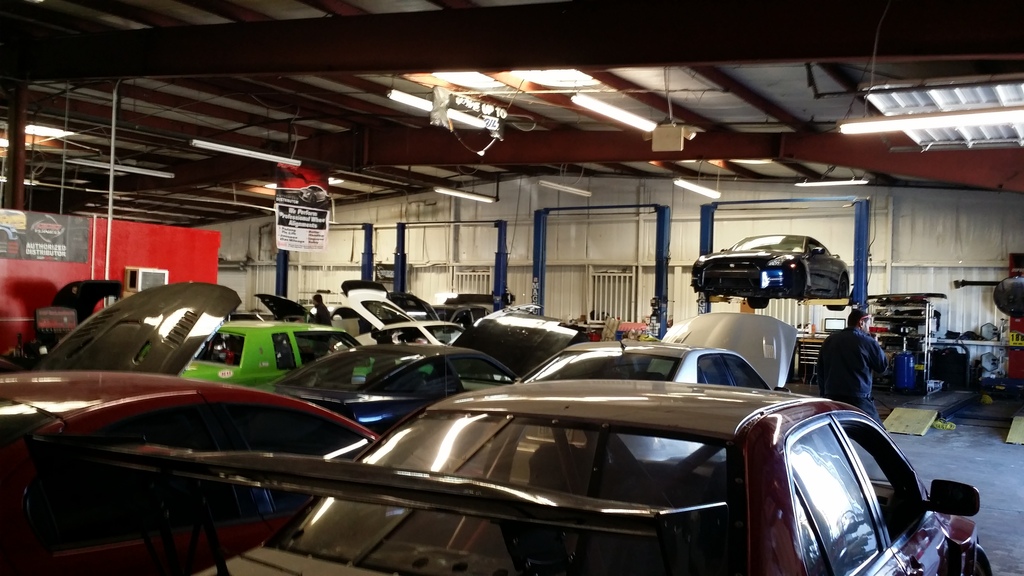

Got it aligned today...
Much better

Felt amazing during my test run post install. Guy who aligned it said he was impressed I had it so close to spec. You can feel a huge difference with the larger tire contact patch up front. I was a bit worried going with the race spec upper control arms but they honestly ride better than my 85,000 factory arms did. Much tighter feel and it removed almost all my tramlining issues from what I can tell so far. All I need is swaybars now and I'm set
