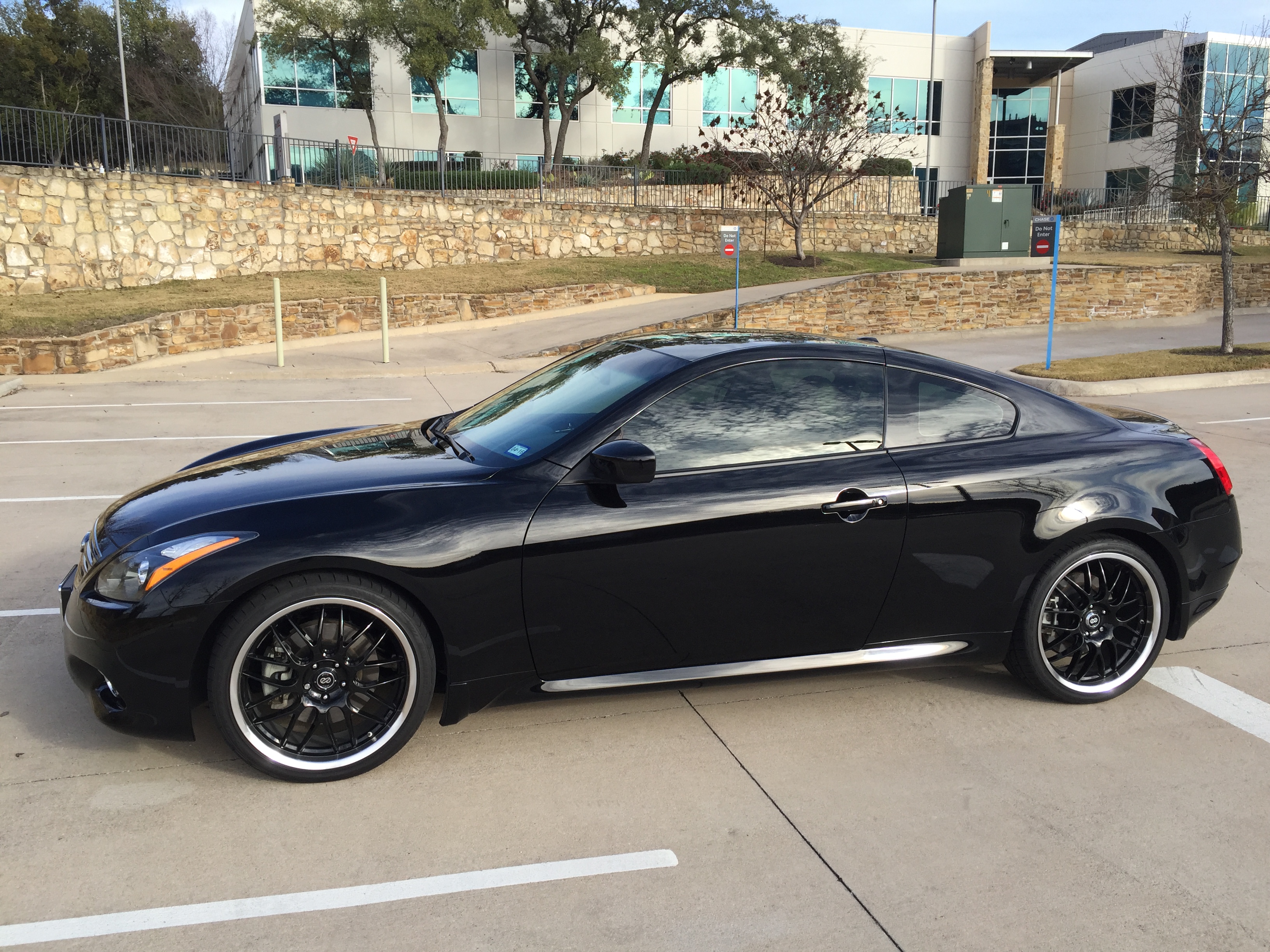

I installed the Swift springs on my G37x coupe two weeks ago and it is a perfect drop. I didn't want it slammed and the stance is perfect and the ride is very smooth.
Did you have to do anything for camber or caster or were you able to stay stock? I have an x-coupe and plan on installing swifts soon. Just trying to get an idea if I should plan on doing it all at the same time if needed. Hoping not so I can spend $ on other goodies!
I've been waiting to make sure the suspension settles before the alignment so planning on getting it done this weekend. Since it is a mild drop, from what I've read on this site no camber/caster kit is needed with these springs.
