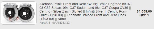

Awesome research Blewt! That would have been nice to be available when I ordered my BBK from Concept Z Performance. I'm glad I spent the little extra and bought their slotted rotors and SS brake lines though. My preference was to have the OEM+ look so the OEM finish on the brakes is worth it for me. The brakes still look and function amazing almost a year later and pad wear has been minimal with the basic Centric pads. They do produce a fair amount of dust however, which isn't too much of an issue as I clean my car regularly.
Having the ability to hit the brakes later and stop faster is such a relief. The OEM sport brakes on my G35S were worn and scary lol. I also bought Dot 4 brake fluid and did a thorough flush of the system which is an important component that should be considered.
Here's my exact config and cost...
