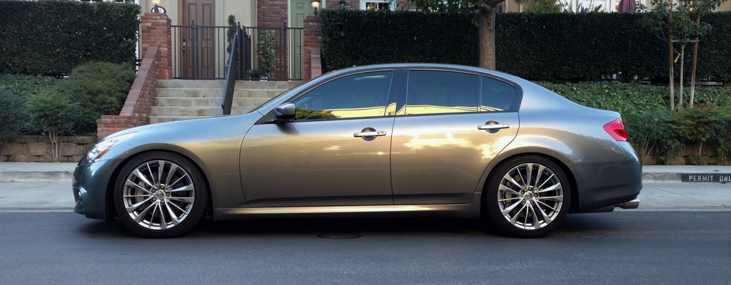

Installed the coils over the last few days, along with SPC camber arms front & rear, as well as the rear toe bolts. A couple of notes:
Front camber arms are super easy when you've got the strut/springs out. Although you do need to put them back in to load the suspension & screw down the arms on the sides.
Rear arms are cake, although the toe bolt is a PITA. As someone else noted, the DIY vids / PDFs all show aluminum subframes, whereas the G37 sedan (and coupe?) has a steel subframe. This makes elongating the hole WAY harder. I ended up using a combination of the 115 Dremel bits and the cutting disks that blnewt suggested. Cutting disks to cut out and Dremel bits to square it out / clean up the edges.
If you use the suggested ride height, it ends up sitting at 26.5 FTG all around, give or take 1/4". I played with the heights endlessly, going down as far as 25.75 in the front, but it looked pretty dumb. I ended back at 26.5 in the end.
One very big note: adjusting the rear height with everything bolted up is an absolute MFer. I ended up unbolting the spring cradle's outer bolt and dropping it down to make any adjustments. It's too tight space-wise and the spring is too tight on the collar to do it otherwise.
Also, those little plastic shims between the collars and springs are brittle pieces of crap. Most of mine are cracked at this point.
My alignment is absolutely ridiculous at this point (I can clearly see toe-in out back, so you know it's super high). I did get a chance to take a quick spin around the neighborhood, though, and they feel pretty good actually (aside from the car feeling very squirrely). The ride is composed and not too bouncy. I have some "great" undulating freeway near me, which will be the ultimate test, but for now I'm not driving it until I get alignment done on Tuesday.
More observations / driving impressions to come.
And because all posts are worthless without pics, here is what it looks like at 26.5 all around. 10 spoke coupe wheels are coming soon, once I get them cleaned up and refinished.

Looks great at that height, especially w/ those coupe 19s. Sorry to hear you had a tough go w/ the toe slots. I thought they were pretty easy after I shredded the 115 bit and just went to the discs. I had my car pretty well lifted though so that may have helped too. Look forward to your impressions after you get the alignment set and put some time on them.
