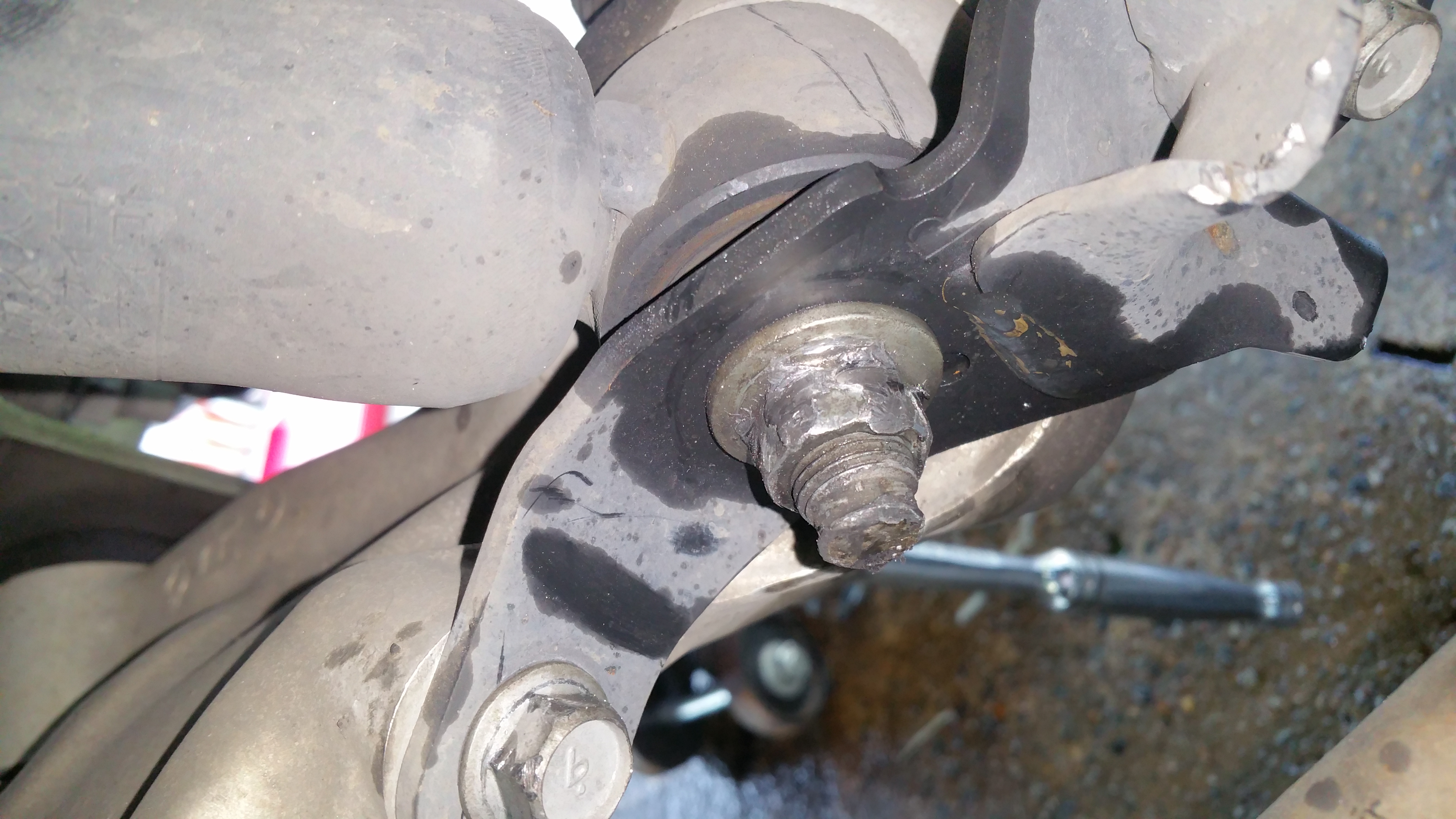

Damn strut bolt
So for some reason this mf will not come loose. Why are they so tight!!!! I was only able to put 1 from spring cause I ran into this problem.
What are my option's? And where can I buy this nut/bolt

dang... have never seen a bolt stripped like that before...
you can grab that bolt from any parts store..
soak it in pb blaster... torch it and perhaps you can use vice grips on it..
otherwise.. cutting the thing and just replace the nut and bolt together..

Ohhh yeah I was just reliving this memory when I put up my build.thread last night. I had the exact same problem, tried everything basically torching and cutting it is how it came off. I was able to grab the replacement bolt from my local pepboys.

Are you guys using 12 point sockets because mine came out pretty easy with a 6 pointer.

I had a 6 point impact socket on impact gun, still wouldnt budge... Although it was 10 degrees out also so Im sure that didnt help

I tied everything.. the fact that I don't have a good leverage causes it to slept when pulling up on the wrench. So it would slip.
Tried impact gun, kicking it, pb blaster, wd40, nothing lol

Are you holding the bolt from the other end at the same time as well?

Yeah I had a wrench on the other side.

You need a damaged nut remover. And torque.
