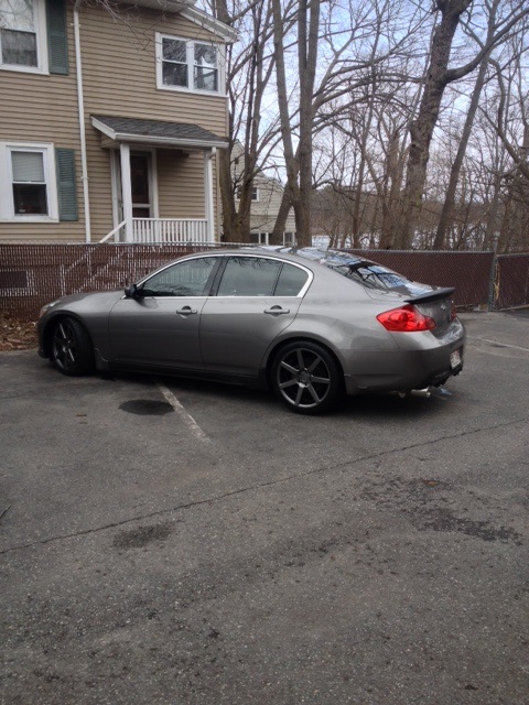

As a fellow X member, Best drop is Swifts, NO one makes upgraded shocks or struts( That I've seen). So he Koni's etc are out. You know already but there are no coilover options for us that wont make noise. If your on the stock wheels 20mm all around will get you flush. An hotchis sways are a great choice. I have the above minus the stock wheels( 19's no spacers in the summer) the ride is great the drop is perfect and being in Boston that says a lot , as roads here SUX.
I do run the stock 18's sport wheels in the winter with 20 MM all around tho.

My BC's made horrible noises! Not sure about the RWD cars but the X cars have nothing. Just springs. I had H&R's drop was TOO low I scraped everywhere. The Swifts are perfect

Stockers and almost 73k
