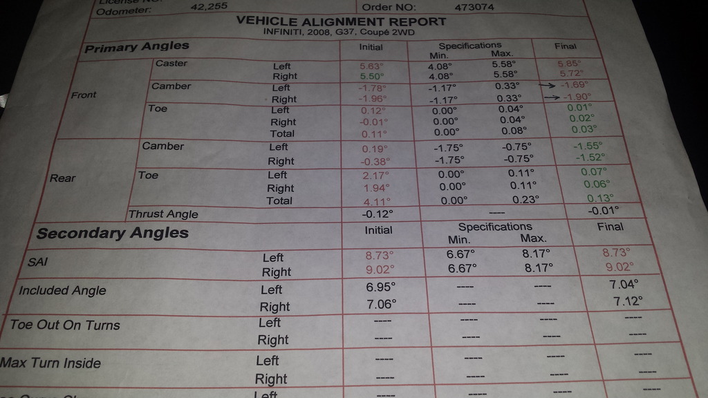

here are the specs from the shop. see below.
i don't even drive on the highway, i mostly drive in city streets so mostly stop and go, still the first set i burned through were the re760 from bridgestone, now my second set that i burned through on the rear are falken PT722. you think it's the suspension??

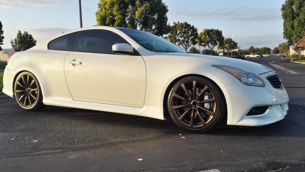

Those specs don't look bad, the front camber is a bit high but your toe F&R is fine and your rear camber is good, this shouldn't result in crazy tread wear. Do you have pics of how your G is sitting now?

blnewt - the front is not the issue, front tires don't look a day old. the rear is what is troubling me! I'm thinking of going with Continental DWS. the current setup is 245/40 front, rear 275/35. i think i want to go bigger on the rear so like 275/40.
plus I'm looking for an alignment shop in oc preferably or LA.
heres an old picture but its the same..Name:  20140928_071951_RichtoneHDR_zps858c81c6.jpg

Did you get that alignment recently? If not you may have hit a pothole or something else that may have jarred your alignment off.
That pulling into grooves is probably tramlining, some tires are more prone to it than others and wider tires especially. Also if you have some very worn tires they can be unpredictable on those kind of roads.
Just going by your alignment sheet your G should have good tread wear.

no, not recently but now that the tires are pretty much toasted I'm going to get it realigned once more after the install of the tires. i wish the tread wear was good!!
SO based off those readings should i still cut "elongate" 1/4" towards the car?? cuz its currently not elongated but my buddy said they can do it when they install the tires.. i'm going to have them check the springs too what if they were installed wrong or upside down? lol but the car drives fine.

Just basing it on those alignment readings you shouldn't have to do any elongating of the toe slot, but looking how low your car sits I'm amazed that they were able to get the toe/camber in spec without elongating that slot???
Something is amiss here, so I think I'd get that slot widened just to have that tool available should you need it. BTW, were your tires worn evenly, worn to the inside, jagged/raised edges of the tread block?
Seems like something has altered your alignment from that original data sheet, or you've been doing a lot of hard driving that you're keeping a secret, lol.
