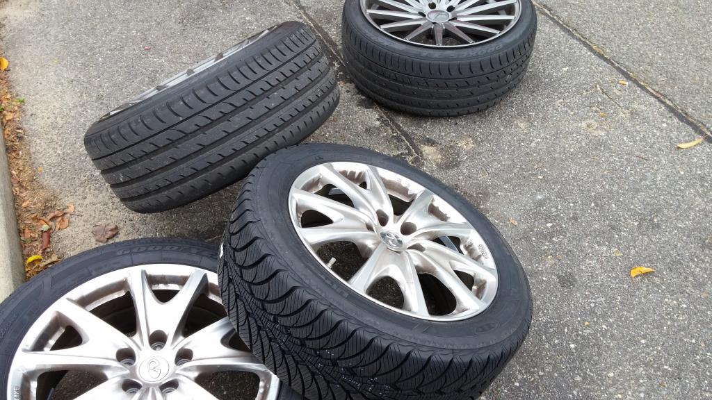

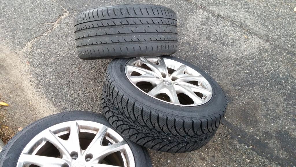

Old Dec 27, 2014 | 08:21 PM
Sunny G's Avatar
Sunny G
Joined: Sep 2008
Posts: 1,020
Likes: 50
This is 20x9.5 +25 with 245/35/20 and 20x10.5 +35 275/30/20
I added a 10mm spacer up front a couple months after these pics were taken.
This is when I took the wheels of for the winter.
Front (you can see camber wear, and this is after about 5k miles)
Rear (also after 5k miles)
