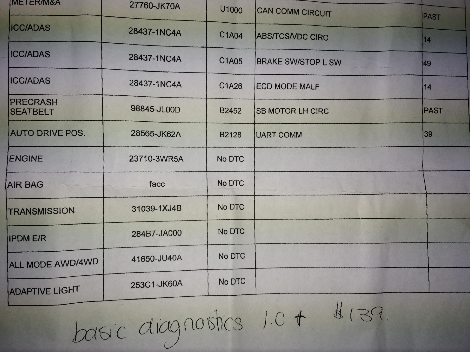

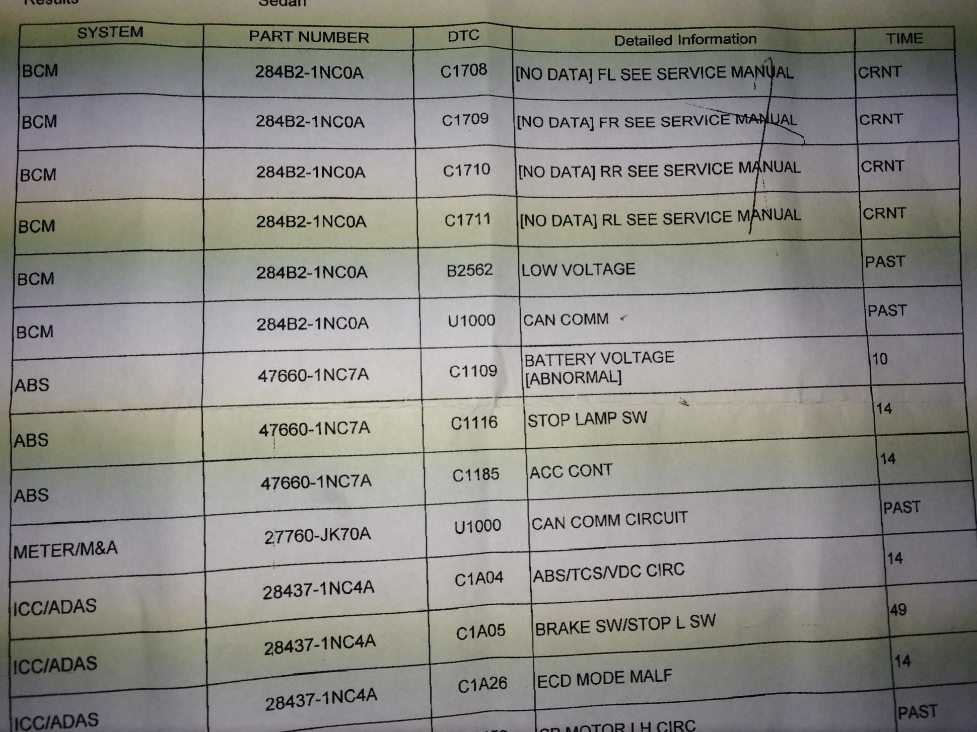

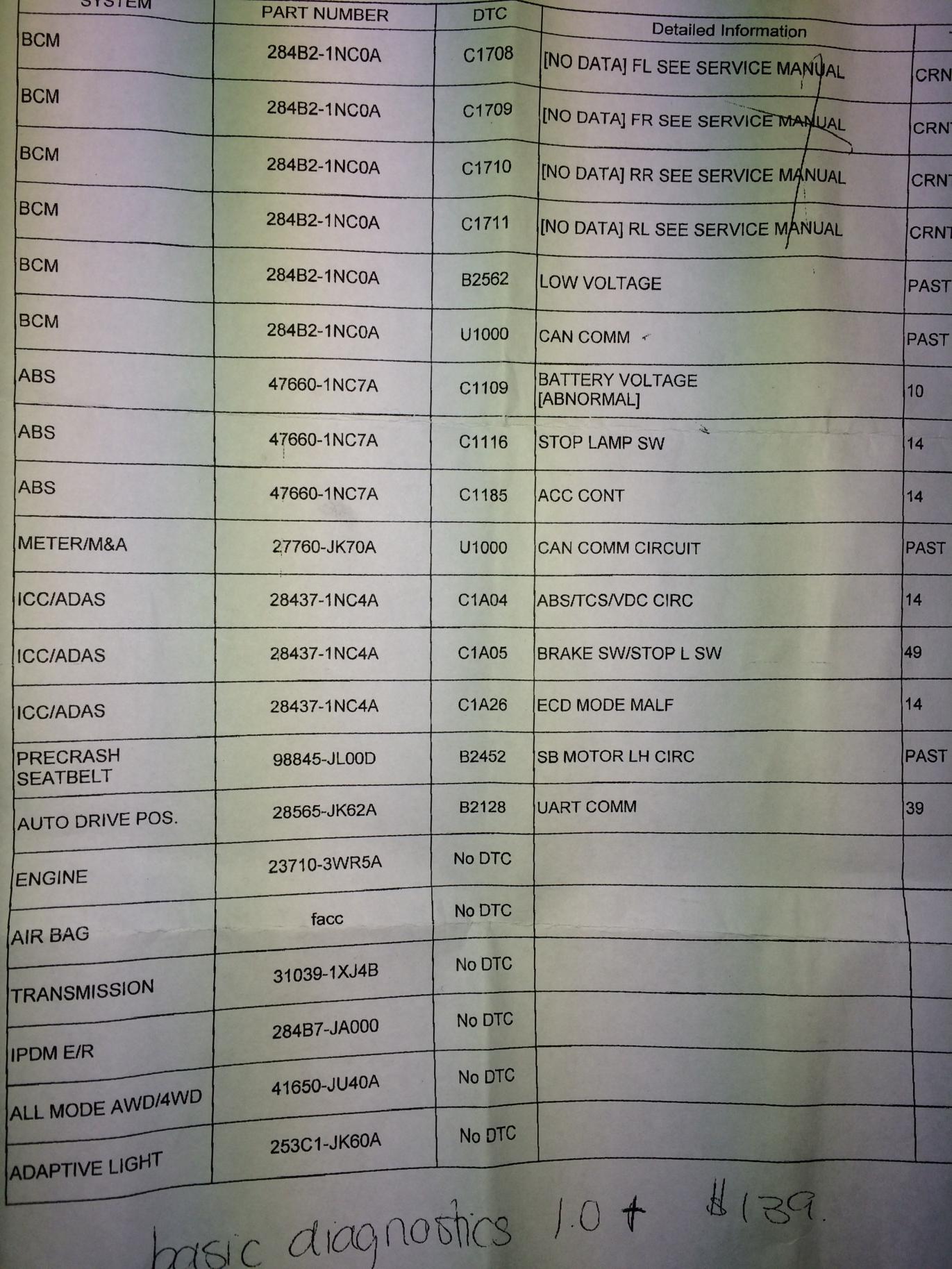

I brought my car to the dealer last week because the VDC/abs/slip light came on and they top it up with brake fluid and after 2-3 days the light came back. So this morning I had an appointment and they said the car showed so many code that they couldn't tell and would like me to bring the car in when the VDC/abs/slip light comes back on cuz they cant tell whats going on, and would like to do a diagnostic while it shows.
The dealership cleared all the code and said to come back when the vdc/abs/slip light come back again and my warranty on the car is over soon in less than 1500 km.
Anyone of you had encounter such problem??
tks in advance.
Attached Thumbnails VDC/abs/slip light-img_3460.jpg   VDC/abs/slip light-img_3461.jpg   VDC/abs/slip light-img_3462.jpg

Aside from the usual suspects in these instances that you already mentioned, I'd have them make sure your battery/charging system is good, and that your brake pedal switch adjustments are all ok. These cars can go slightly insane when voltages are off, and I have personally seen a maladjusted brake pedal switch cause that trio of lights.
