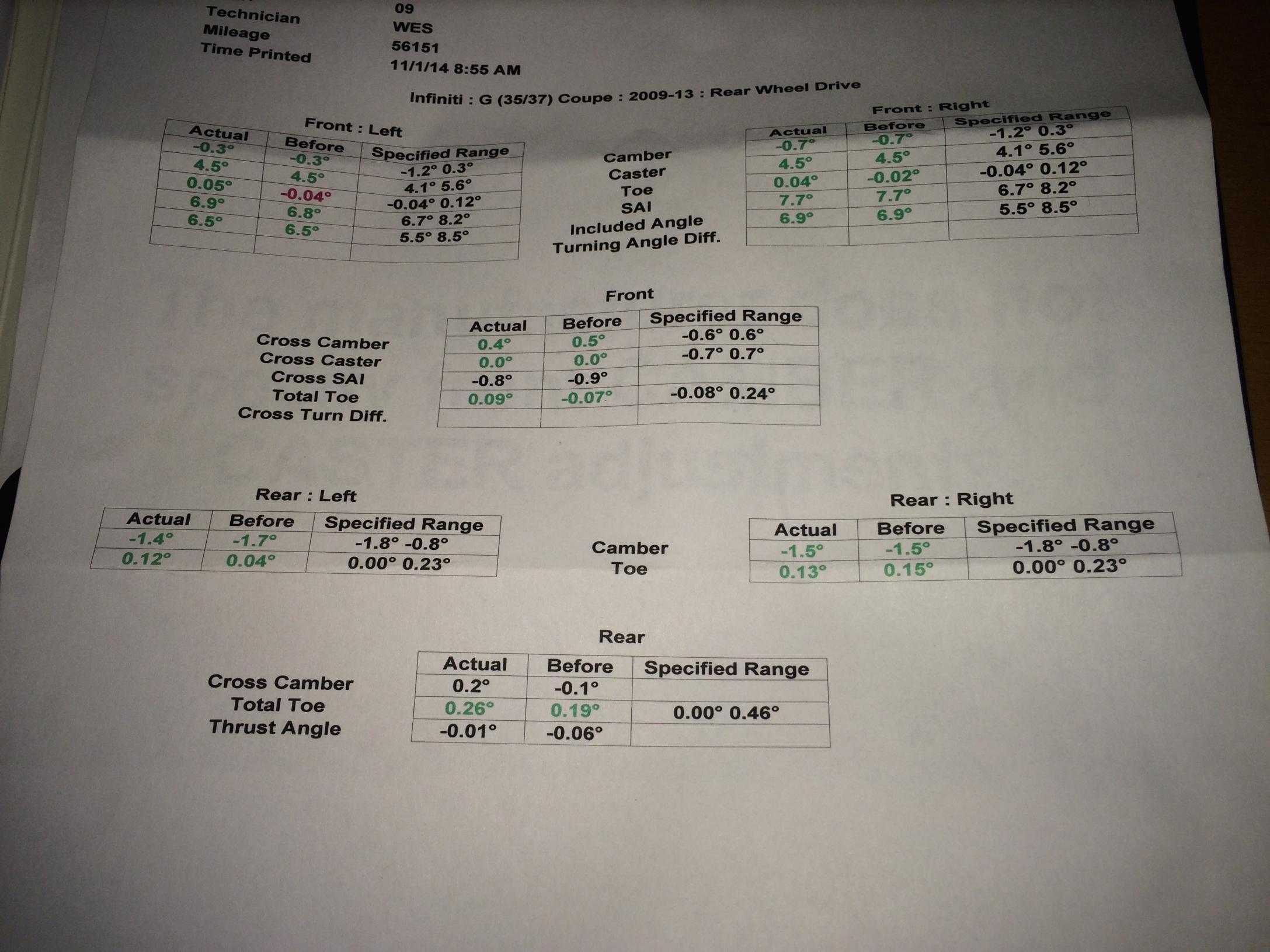

curious. how could you tell that the strut had gone bad? I recently went into the dealership for an oil change and was told that my passenger front was at 0/32" however my driver front still had 2/32" and needed new tires. Went to my tire guy and got new tires while getting the tires mounted tires and the car was in the air did a quick look at all 4 corners and there was no visible leaking of any of the struts. after the new tires were put on i went and got an alignment (big-0 had a great deal on 3-year alignment program) of which apparently only my driver side front was a bit out of spec.
i thought it was weird that only my passenger side was excessively worn however it did not seem as though cupping was occurring it was pretty evenly worn on the inside all the way around. I know that the OEM set up for the car has a bit of negative camber but this seemed odd as it was only on the passenger side.
Thoughts?
Oh ya car is an 09 S coupe with about 56k miles stock suspension. front tires were 225/45/19 hankook v12 evo k110s with about 30k miles on them when i changed them.

no no worries. appreciate the help! i did get a report i'll get a picture of it when i get home to my maintenance folder. BTW i like your tag underneath your screen name "DIY cheapsk8". haha

hope that i posted the image correctly...
didn't notice but attached to my alignment printout on the second sheet it states
"THE MANUFACTURER DOES NOT SPECIFY FRONT CAMBER AND CASTER ADJUSTMENTS"
Thanks again for the help!

Old Nov 8, 2014 | 08:13 AM
Likes: 4,951
Well you can cross the alignment off the list, looks great
And w/ the OEM parts only the toe is adjustable in front
30k life out of summer tires is pretty rare, some tires really accelerate their wear when they get to a certain point. It's possible your tires were due for replacement quite a bit earlier than when you replaced them.
Did you rotate side to side (since they were staggered), this should help to even out that wear. Also do you notice any pull to one side either when braking or coasting?
