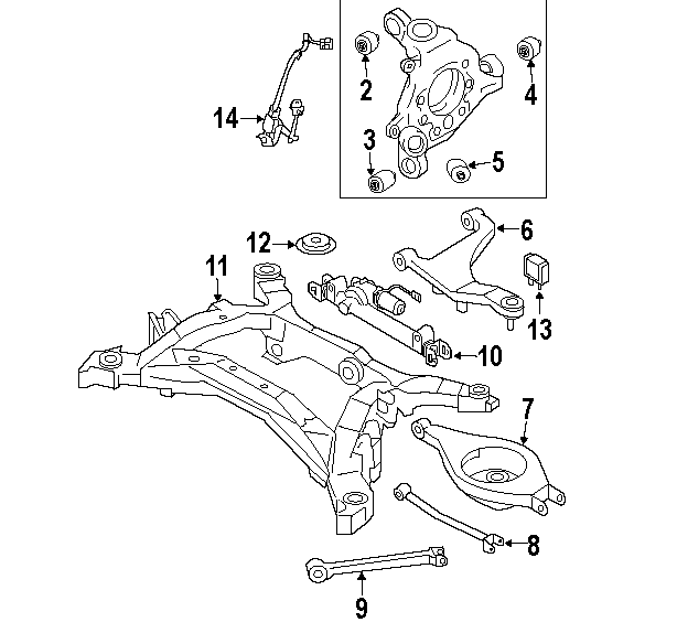

I come back from vacation to find my little brother curbed my rear wheel kindy nasty. Didnt look bad but lower control arm and camber arm where bent and wheel was a little messed up.
So far changed parts
Tire
Rim
8 clearly bent
9 Clearly bent
Waiting on 7 looks normal
Reference diagram
Hit the wheel at its lowest point. So impact was at 6oclock. The car is a lil lower on that side not by much but that leaves me to believe that lower control arm spring buck is comprimised.
Steering wheel is tilted and toe is horrible.He suspects the piece holding the spring a messed up (part 7). Im freaking out because the wheel left wheel is like 1' inward ( normal ) and the right affected wheel looks flush. Why is that? What part could be bent or damaged. Taking it to a suspension specialist thursday.

The lower control arm is also your spring bucket and that could be tweaked but you said that was replaced
Sounds like you're already into this repair for quite a bit $$
Wondering why your steering wheel is tilted if it was a rear tire involved. I think I'd take it to a different shop for another alignment.
G/L

I did not replace the spring bucket. We think its that as the tech adjusted toe on the top. But when messing the spring bucket it would reset the toe to status quo.

So going to replace lower control arm and get it realigned. On a bright note my project E30 with M50 swap is running.

All fixed now. Turns out lower arm was the issue. Aligned to spec. Thanks
