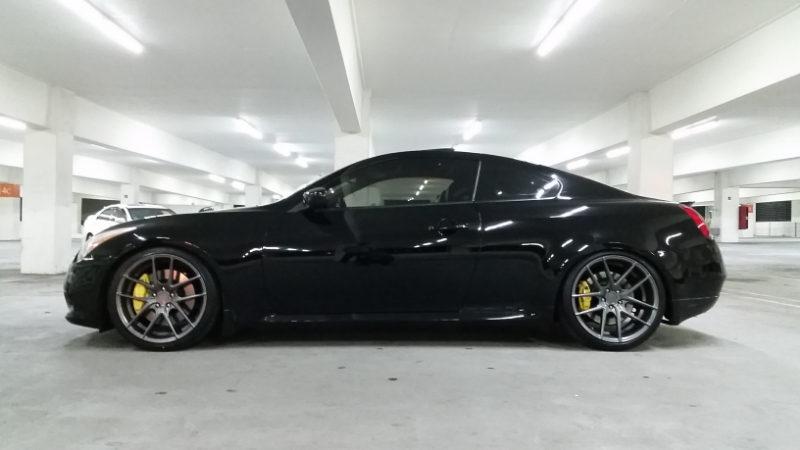

i just install the S-tech few weeks ago and i like how it looks... and looks nicer with 20" rims it fit perfectly!
BEFORE!
AFTER!
20" RIMS!

how do you like the ride quality of the s techs? looks like camber kits will be a must whether you go eibach, h tech, or s tech, so the only difference is drop and ride quality. i have s techs on the way but debating whether to keep them
BEFORE!
AFTER!
20" RIMS!
Old Feb 3, 2015 | 05:02 PM
epenbecks's Avatar
epenbecks
Joined: Sep 2014
Posts: 184
I didn't feel big different for the ride quality. and also i don't use any camber kits on my car. i'm using 245 front and 275 rear for the tires.

Check your tire wear over the next few thousand miles, it's not going to be pretty.
