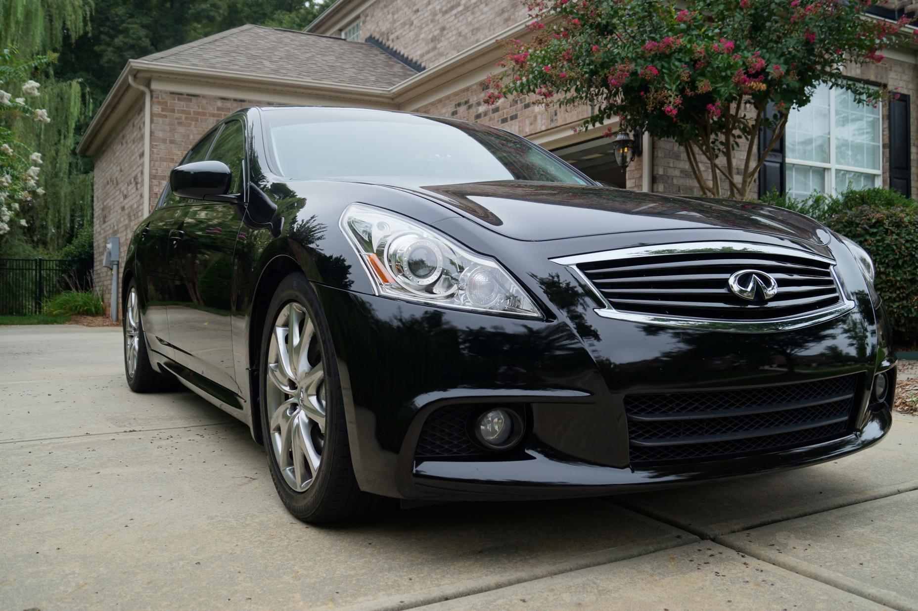

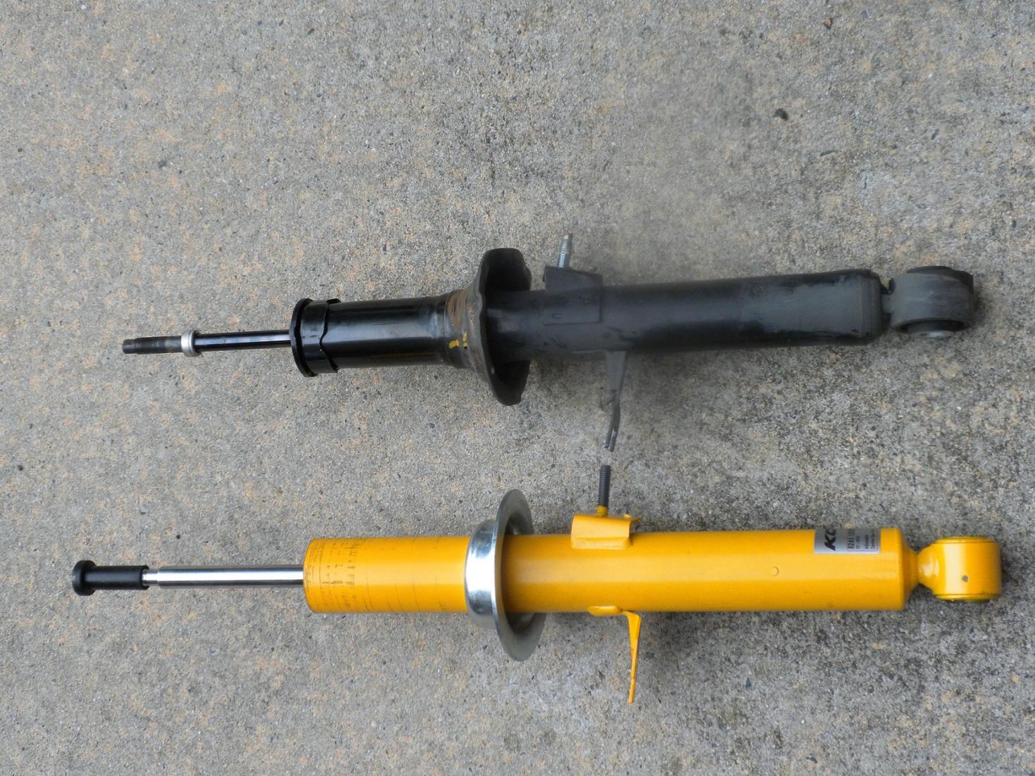

I didn't say they raised the front
There is speculation, which I didn't observe in my koni install, that they raise up the front. This is likely due to people installing the lower perch upside down, or their OE shocks were worn and sagging already.
My Koni + Swift drop was consistent with the drop people get on Swifts + OE shocks.
I'm pretty sure the X suspension pieces are different and the Koni yellows wont fit.
Attached Thumbnails KONI yellows for sedan-koni-swift_after.jpg   KONI yellows for sedan-after2.jpg   KONI yellows for sedan-front-stock.jpg

^^check out the pics of the front shocks. The silver metal lower perch needs put on the shock. If it were to be reversed, it would raise the car.
But yeah, sorry man, maybe coils?
