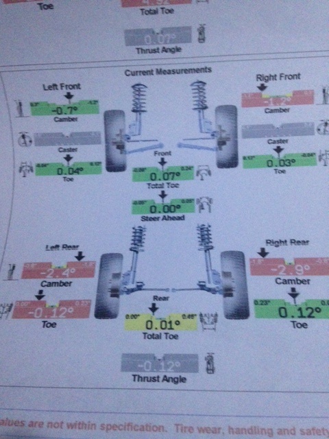

Hey guys i just installed the SPC camber kit set, and am not happy with the results, before the kit i had about 3degrees camber, now with the new kit its at the same place.. the guy alligning the car said this is the max in the rear and to tell my wife to get me life insurance because this is not safe at all?? i thought to myself this isnt a nice thing to say to a customer but i didn't say anything at all and just let him finish his work.. attached is a copy of the report. anything im missing? and also im lowered on H&R's

Wow, that is very odd. H&R springs do have a VERY deep drop, but I think you should be able to do better than that with the camber kit. IIRC, factory spec in the back is -1.8ish.
Why is one toe + camber and the other -?
Who installed the camber kit? Can you verify that they maxed out the camber arms in the rear? Take a pic of where the turnbuckle sleeve is.

did you widen the holes when you put the bolts in the rear?
also -3 degrees of camber isnt even that bad... just make sure they are the same
make sure your toe is in spec it will help your tires last a little longer

That shop is either incompetent, didn't use the rear toe kit, or used the rear toe kit without elongating the slot. Those kits will allow you to easily get in spec if everything is installed properly. They've probably never done one of those toe kits before, or are just lazy.

Dumb question but was it a full kit (front A arm and rear arm)? Front seems ok but no way you will be in the -3* with camber arm in the rear. Take pictures of kit on car.

150 for installation?!
That's your issue. No way they drilled out the slots for the toe bolts. That in itself takes an hour. My install took 4+ hours for Ron Bergenholtz to install and adjust.

i called them up and told them the situation, he said he installed everything including the new bolts, he did not widen the hole in the rear, the process took about 3 hours in total. how much would it be for your installation in la?

Yep, problem almost solved, if they didn't widen the toe slot there's no way they're getting that camber down while keeping toe in spec. Widen the slot, and realign and you should be good!
And if they've done a lot of lowered Gs but didn't widen the toe slot then that would fall into the incompetent or lazy category
