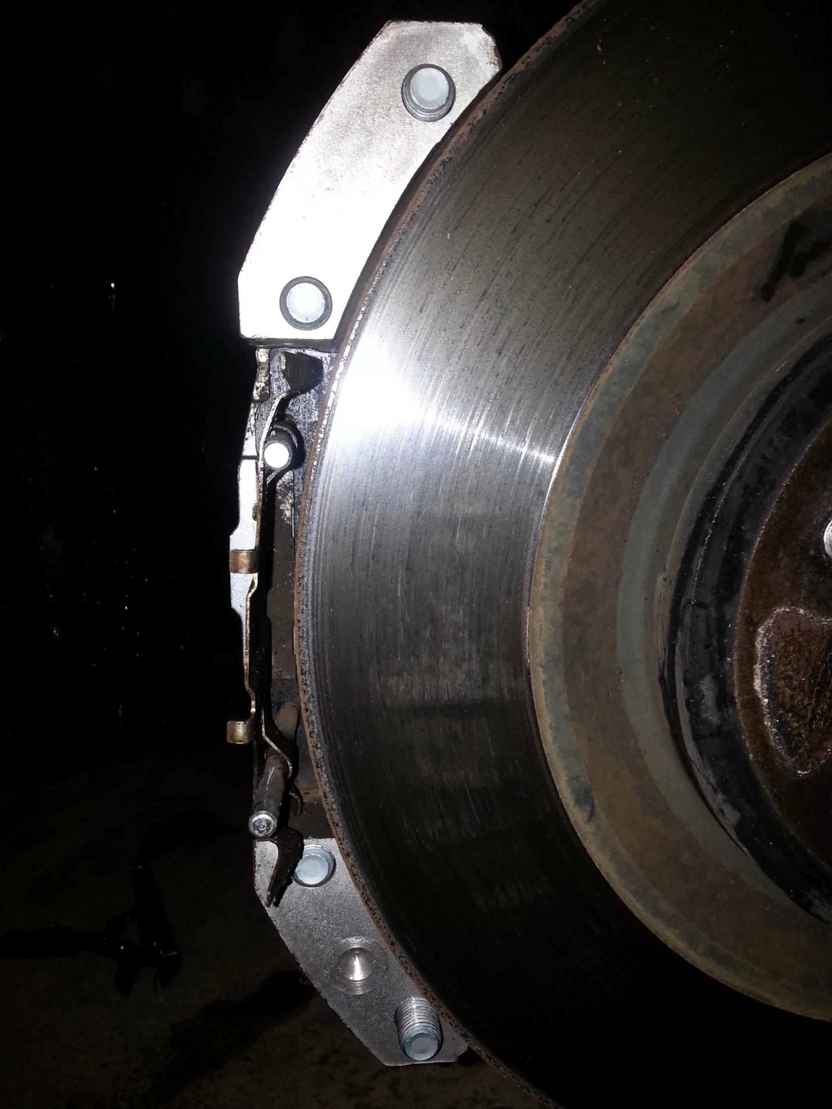

But before anything I just wanted to take it apart one more time and see if the rubber piece is still there. I know most people thought that I needed to rebuild the pistons.. but after I put everything back together correctly, it worked!!! (Don't forget to bleed out) I took some pictures in case there are people like me searching for answers : )
Attached Thumbnails I need help with Akebono Calipers!!!-20140305_090559.jpg

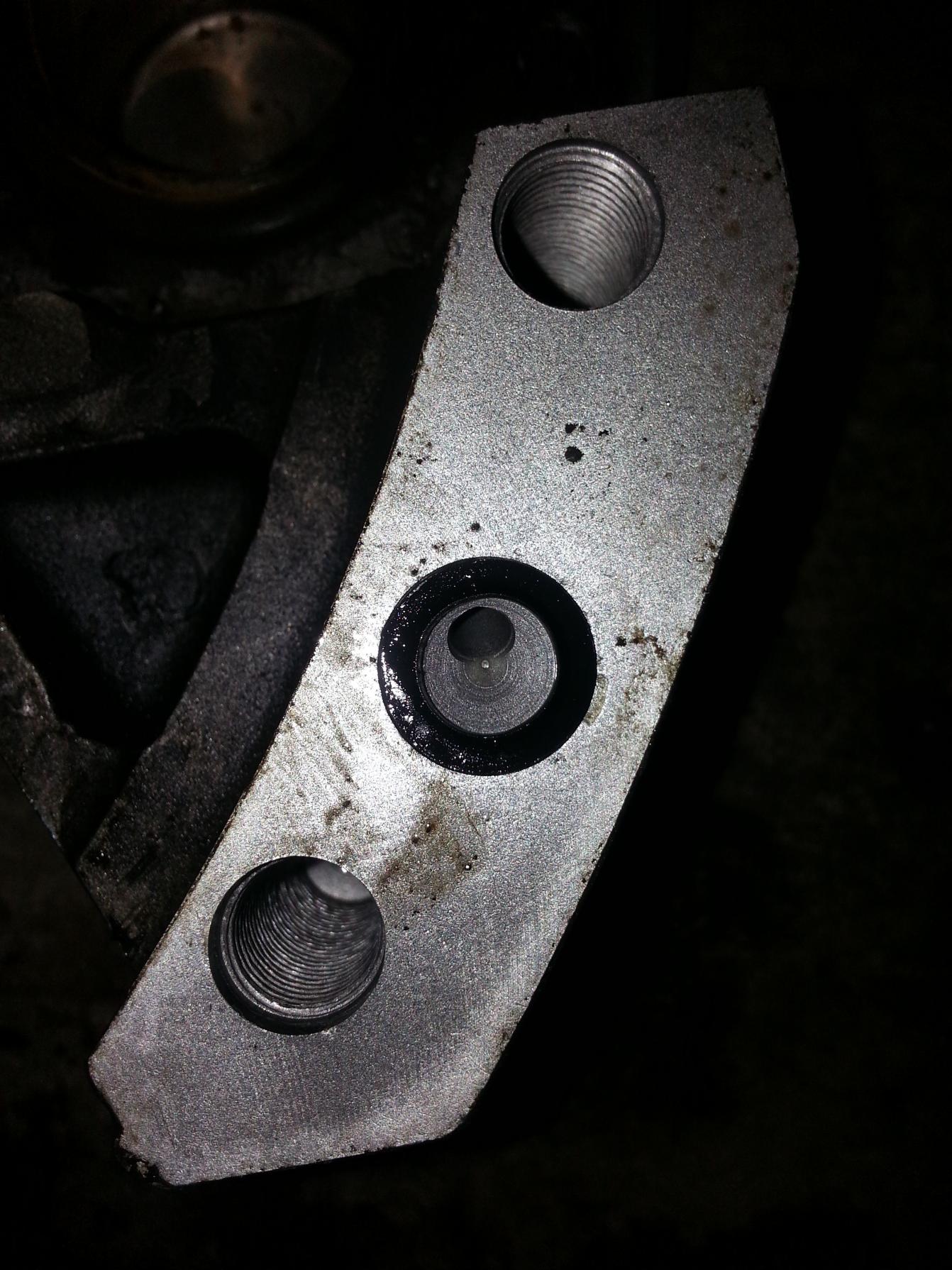

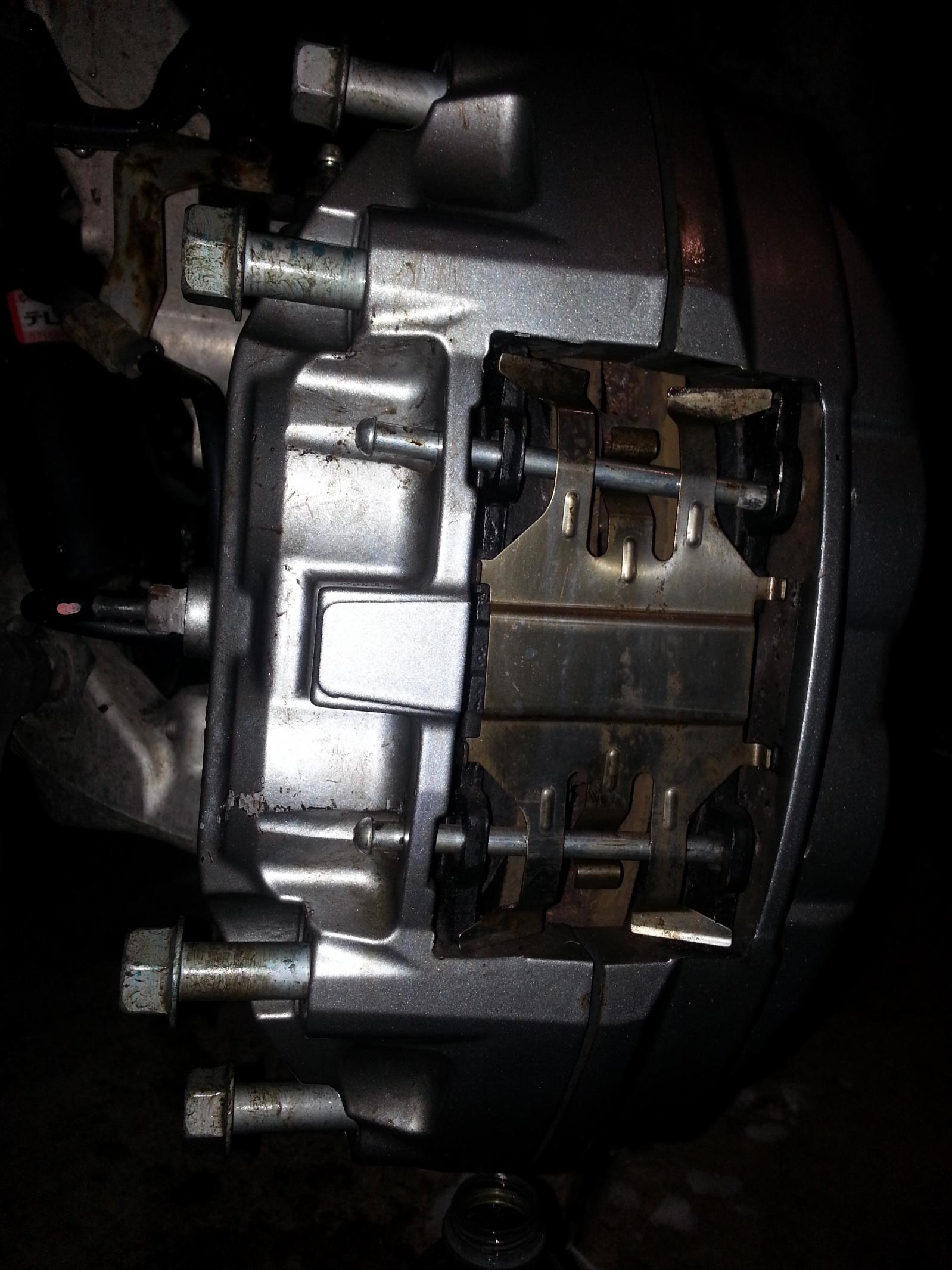

Pictures
Pictures by request!!
NEVER UNSCREW THESE 4 BOLTS!!!
THIS IS THE FRONT DRIVER'S SIDE
THE OTHER SIDE
CLEAN IT
AND MAKE SURE THE RUBBER PIECE ISN'T DAMAGED
ANY QUESTIONS PM ME!!
Attached Thumbnails I need help with Akebono Calipers!!!-20140305_090413.jpg   I need help with Akebono Calipers!!!-20140305_090559.jpg   I need help with Akebono Calipers!!!-20140305_090624.jpg   I need help with Akebono Calipers!!!-20140305_090614.jpg
