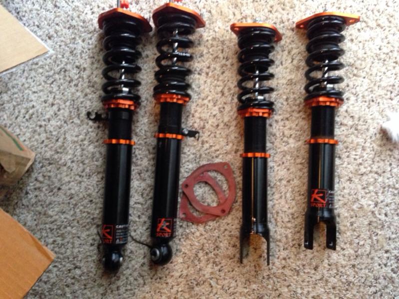

I have ksports sitting on my floor with an SPC camber kit, I'll try to install it this weekend.
Old Feb 28, 2014 | 09:13 PM
GoFightNguyen's Avatar
GoFightNguyen
Because Racecar
iTrader: (14)
Posts: 2,543
Likes: 759
They're pretty clean, I got them used.
