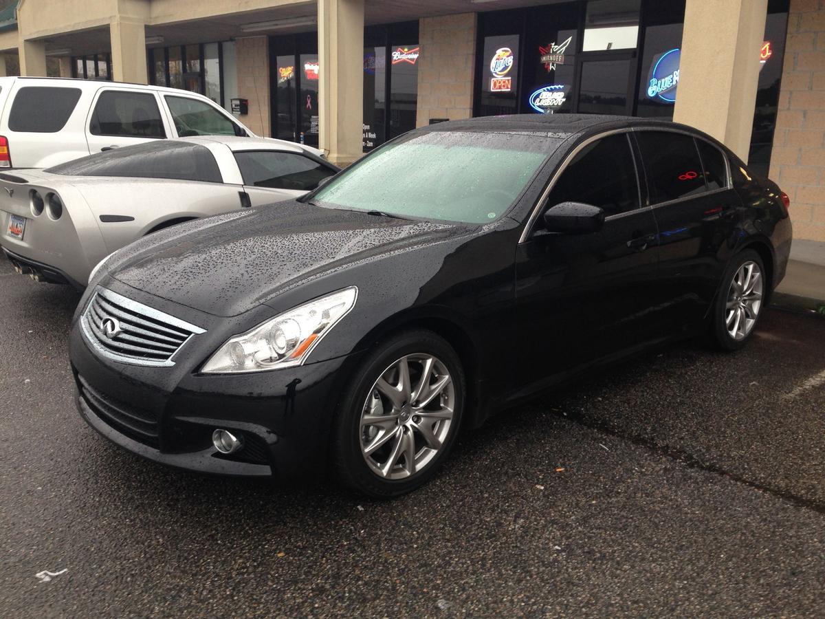

Hey everyone, I just bought a 2010 G37S last week and I love it! I've already purchased spacers from B2 Auto Designs (20mm all the way around). I think the only other thing I really care to do would be springs to close up the wheel gaps a bit (roughly .75" in the rear and 1"-1.25" in the rear) without losing much comfort. I had a couple of BMW's in the past on H&R Race springs and they were a pain going up curbed driveways and speed bumps so that's not really what I'm looking for. I've done some searching on the forum but the majority of the vehicles I've seen in the posts about springs were the AWD models. Would some of you who have "S" models mind posting pics of your setups? Sorry for the wall of text and thanks in advance!

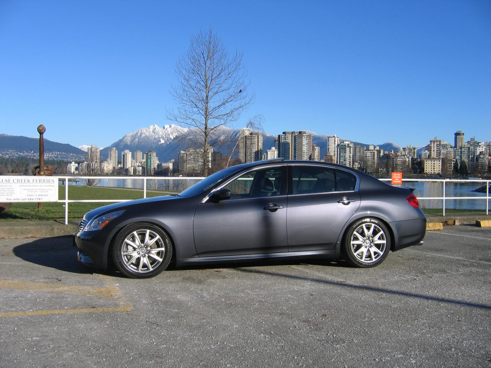

this was my RWD S on eibach pro kit and 20mm H&R spacers. great stance, i absolutely loved the look. i have since gone back to the stock springs and no spacers, but added eibach sway bars front and rear. sways did much more for handling. springs are for show, sways are for go. combo'd up might be a good idea, i just couldn't live with the ground clearance on the prokit. many guys do not have any issues so it may just be the Vancouver streets ans traffic calming speed bumps...
oh, and those crappy Kumho's are long gone. proper tires are probably the best "mod" for handling.

^^ when you put lowering springs on the G the suspension tucks in more. that's why many guys who lower put on spacers to bring the rims back to flush fitment. on stock springs the fitment is close enough for me not to need spacers. plus, spacers do put a bit more wear on the hubs (longer lever arm) and i plan on keeping my ride fro a while.
guys on stock springs also use spacers occasionally, but i opted not to.
+1 to what Deelow said - if you go with spacers be sure to hand torque your spacers and wheel nuts with a torque wrench.

Thanks for all of the responses! I think that pro kit may be raked a little too much for my liking or is it just the picture angles?

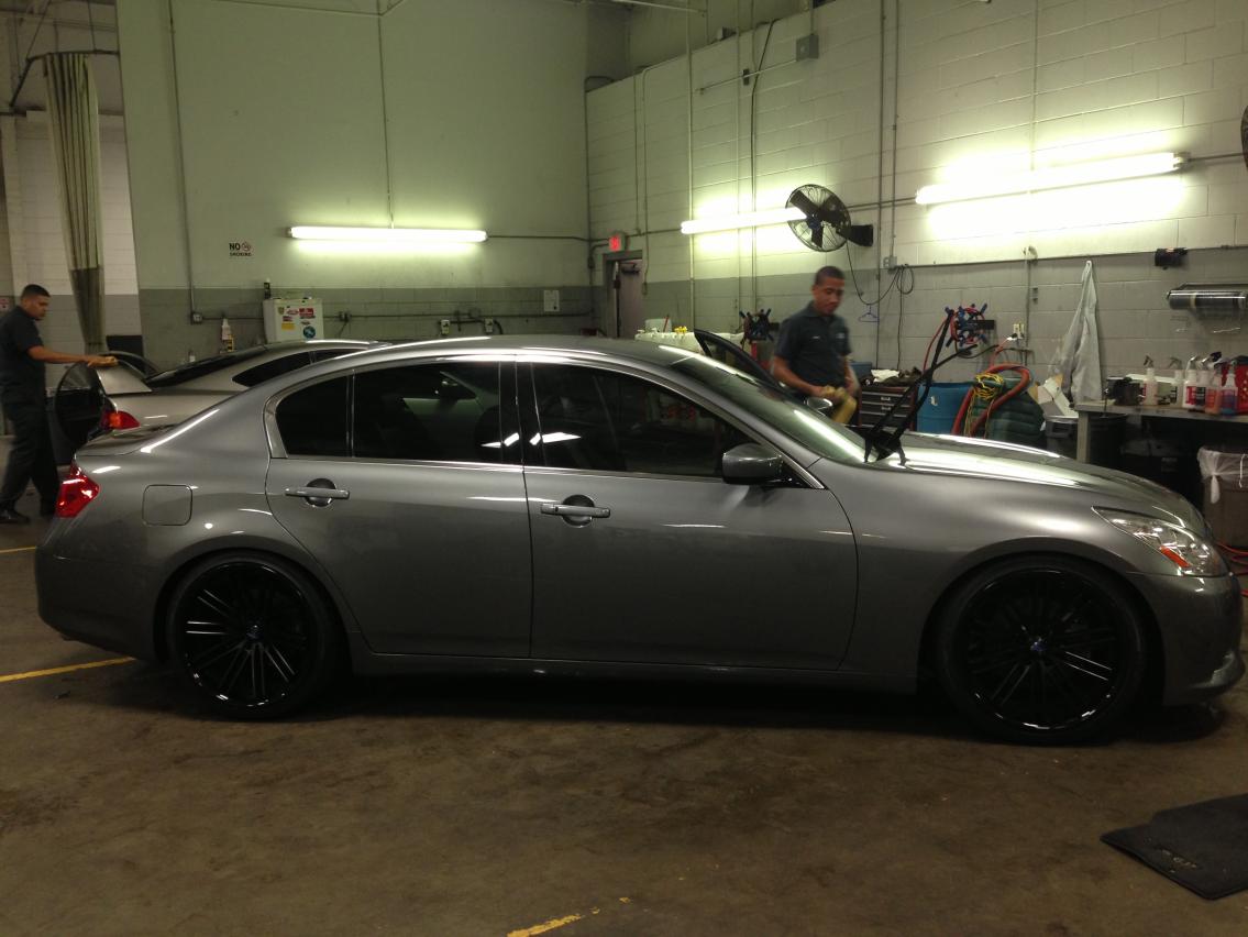

Here is a picture on tein S techs. I am pretty even all around. They might be alittle lower than what you are looking for but if you are planning on getting wheels, it gives it a great look pretty close to being flush on 20s.
