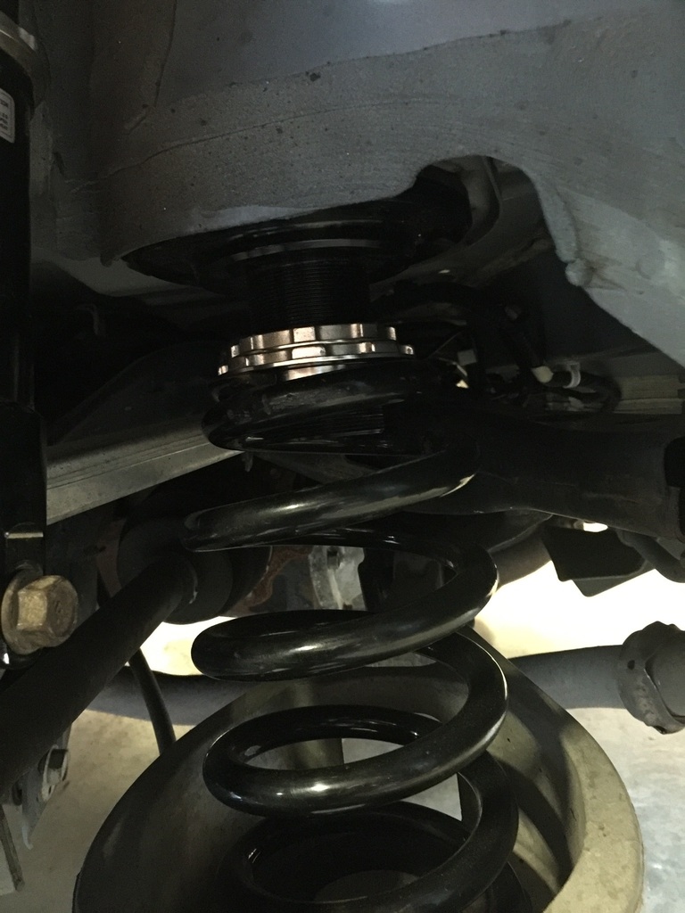

This seems to be the most informative thread so far on the BC coils so I'm going to post my experience so far here.
I got the rear coilovers installed last night and the height adjusted. I do have some noise in the rear, but I have yet to set shock preload. I won't knock them yet until I completely finish the install. A couple takeaways:
-26" from the fender lip to the ground seems to be the sweet spot imo. No gap, but not too low and still fairly maintainable. I can't get my low profile jack under the back of the car straight on, but it slips under the car on the side jacking points just fine. I may make some wooden ramps at some point to solve this and make it easier to jack up the rear quicker.
-Where the upper spring perch is located in relation to the sleeve from passenger to driver side is dramatically different. I wasn't expecting this. I'm about .4" from being fully maxed out to the lowest height on the passenger side (the setting in the pic below was at 25 7/8" height of the fender lip. I raised the car / lowered the collar 1/8" after this pic to achieve exactly 26" ride height):

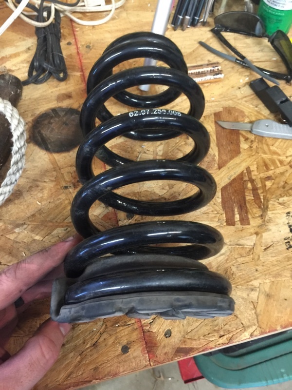

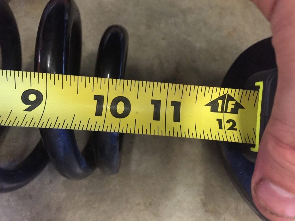

-This is causing the spring and upper mount to have some motion with the shock and control arm bucket bolted up. I'm sure this isn't helping with noise. I'll know more after I set the shock preload. It almost seems as of now that the spring is too short. Uncompressed I measured at 10":

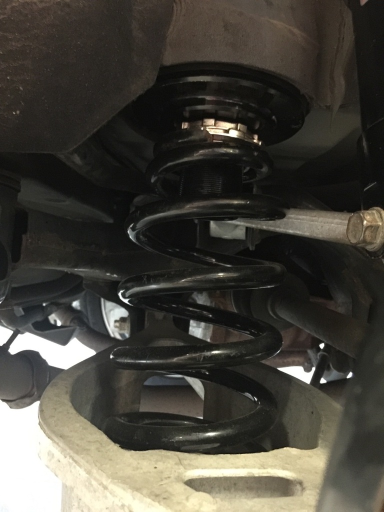

-For reference here is where the collar is adjusted on the driver side to achieve the 26" height I want:
I've had this exact problem with my BC coilovers. After contacting BC, spending hours troubleshooting the install, pre-load, and defective parts, I decided to sell them. The noise in the rear coilovers drove me crazy. I hope you have better luck with the set.
I know 4 G37 owners with BC coilovers. 3 of them have noise in the rear and just live with it.
