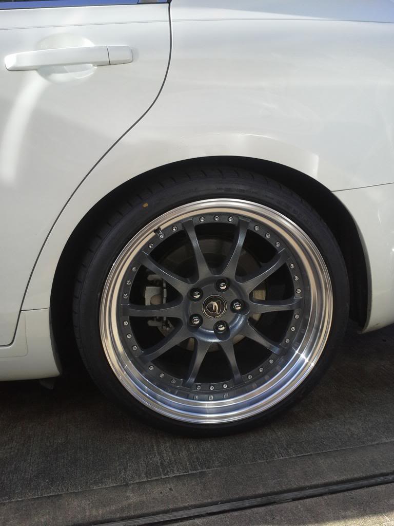

Been a week since my install and my back doesn't seem as low as everyone else here I've seen with swift springs. Shouldn't they have settled by now?

Are you on stock wheels? Do you have pictures of drop? The tire profile sometimes makes it look off.
Tire size is 275/30/20

your on 30 wall so your tires are skinnier than stock
get 40 or 45 to fill it up more

No don't switch to taller sidewalls, you really need to keep your diameter close to OEM size, the 275/30/20s are the proper diameter for that 275 width, going to a 40 or 50 would bring all sorts of issues to your traction control, ABS, and your speedometer would be way off. Post a pic of your whole car for a better reference if you don't mind.

Blnewt is correct. You need to stay with the 275/30/20 as it's close to OEM. Measure with a yard stick from ground to the top of the wheel well. You should be at or around 27" for front and back. If not, you may have had the springs installed incorrectly.
