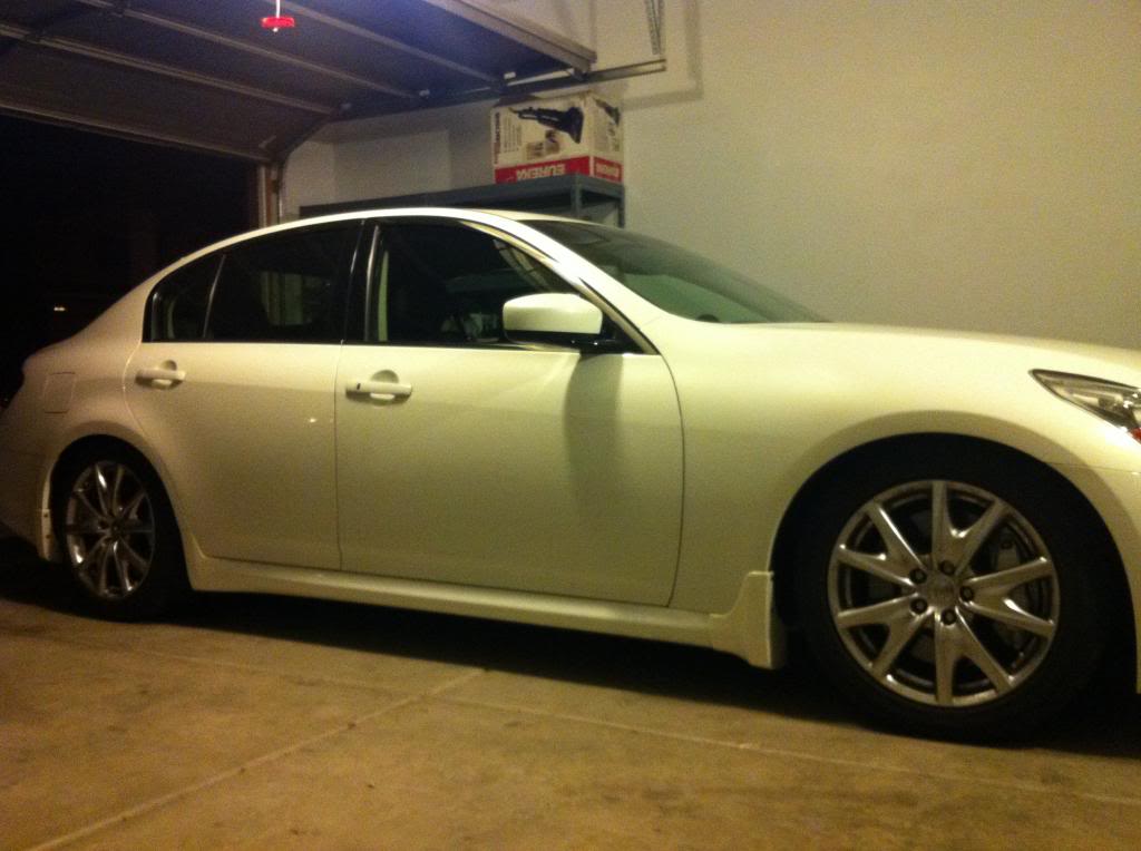

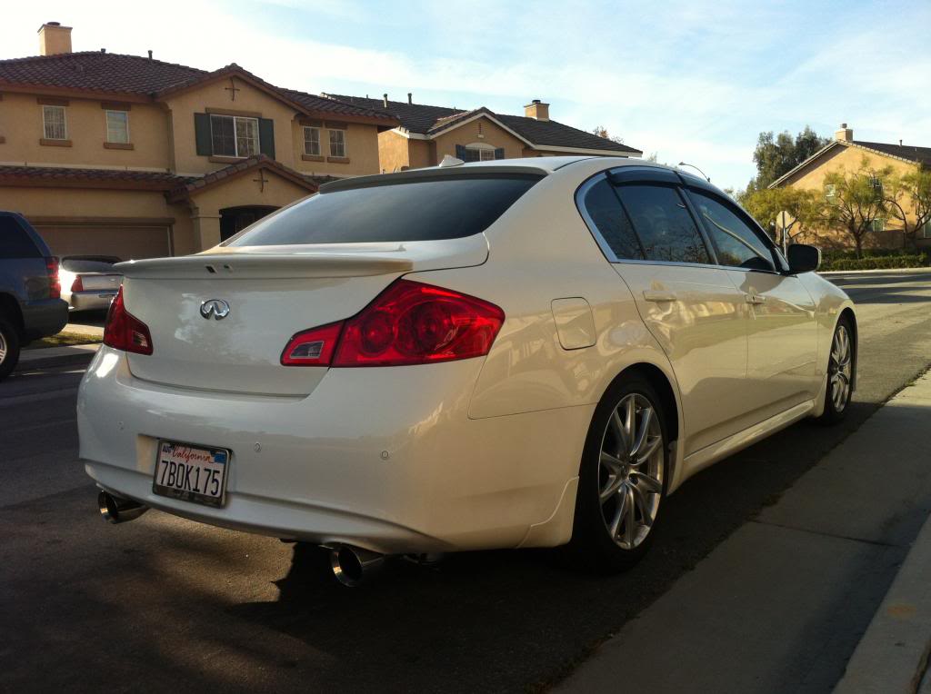

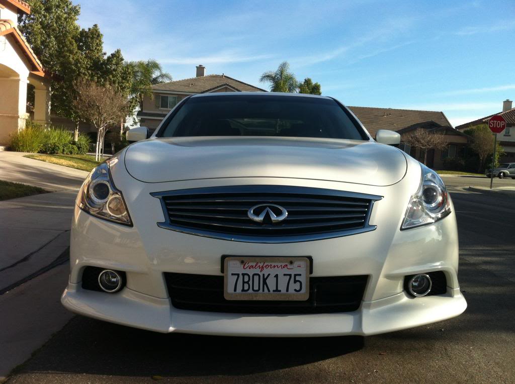

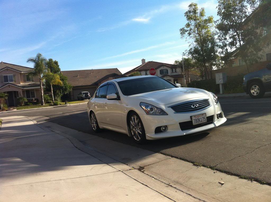

I have a 2013 G37 Sedan and I lowered the vehicle on Tanabe Coilovers about 2 weeks ago. I took it to have it aligned and it's pretty crazy how much my camber is off.
Front left: -1.3 (not too bad) from -1.7
Front right: -2.2 (Yikes) from -2.5
Rear Left: -1.4 (Not too bad) from -1.7
Rear Right: -2.2 (Yikes) from -2.7
The alignment guy said I can't really fix fronts since I don't have camber plates. he did correct the rear a bit. I got an alignment so I can slap on my rims tomorrow. I didn't really expect camber to be this off. Are my tires toast (especially the right side)? Also, something tells me my right side is lower than my left side given the camber degrees... What do you guys think? These are my first coilovers. I have been lowered on springs on past 4 cars.
Here is my car. 3k miles on the odometer (3 months old).

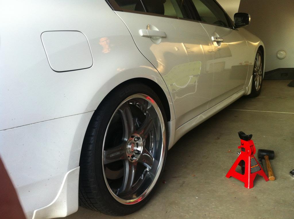

Tomorrow's to do (Volk GTC in gunmetal):

The main tire slayer is actually toe, not camber. Keep your toe as close to 0 as possible. 1-2 degrees of negative camber is not bad. No it doesn't matter which wheels you had on for the alignment. Yes your passenger side could possible be lower. You can always flip your tires down the road if you think they're showing camber wear (take rear tires off wheels and re-install on opposite rear wheels, same for fronts.)
