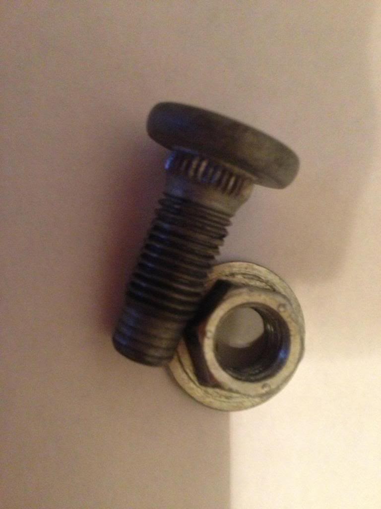

Update/Solution: the bolts holding the brackets of the rear sway bar in place are spot welded in two areas of the head of each bolt. The bolts holding the front sway bar brackets do not have spot welds. (Sorry no pics.) What does this mean? If the bolt breaks off or the threads become stripped you're screwed. No pun intended. (Yup that just happened! Lol) Remember these bolts have a ribbed neck which is not very long, only 2-3 mm, unlike wheel stud bolts that are maybe 10mm+. Therefore, the welds do not allow you to simply punch out the bolt. I went to several shops and their consensus was that because there is no room to properly remove the welds they would need to cut off this part of the crossmember just to gain clearance to remove the welds and ultimately remove the bolt then weld it back on. Alternatively, I could install a new rear crossmember. Quotes ranged from $1K-$2K. One shop told me price is high due to it being a "custom style" job. I didn't comprehend that because these are "oem" parts. Thankfully there was one "custom style" owner who told me just to drill through what's left of the broken bolt to fit in a new bolt. So, I ended up doing that. Yes, this is Tokyo ghetto style - although I have a hole to put in a new bolt the head from the old bolt remains in place with its lovely welds. I don't care at this point. It has been too long not driving this car. I plan to drive it until the world runs out of gas anyway.

Do you even read, bro? Lol! Just kidding. I need to remove the rear wheel to take a good picture of the area. In the interim, here's a picture of the bolt and nut I've referenced to.

The bolts holding my sway bar brackets look nothing like what you posted. The OEM ones or the Hotchkis ones. What you posted does look like a wheel stud. I don't have anything that looks like like that on my sway bars. Maybe I'm weird???

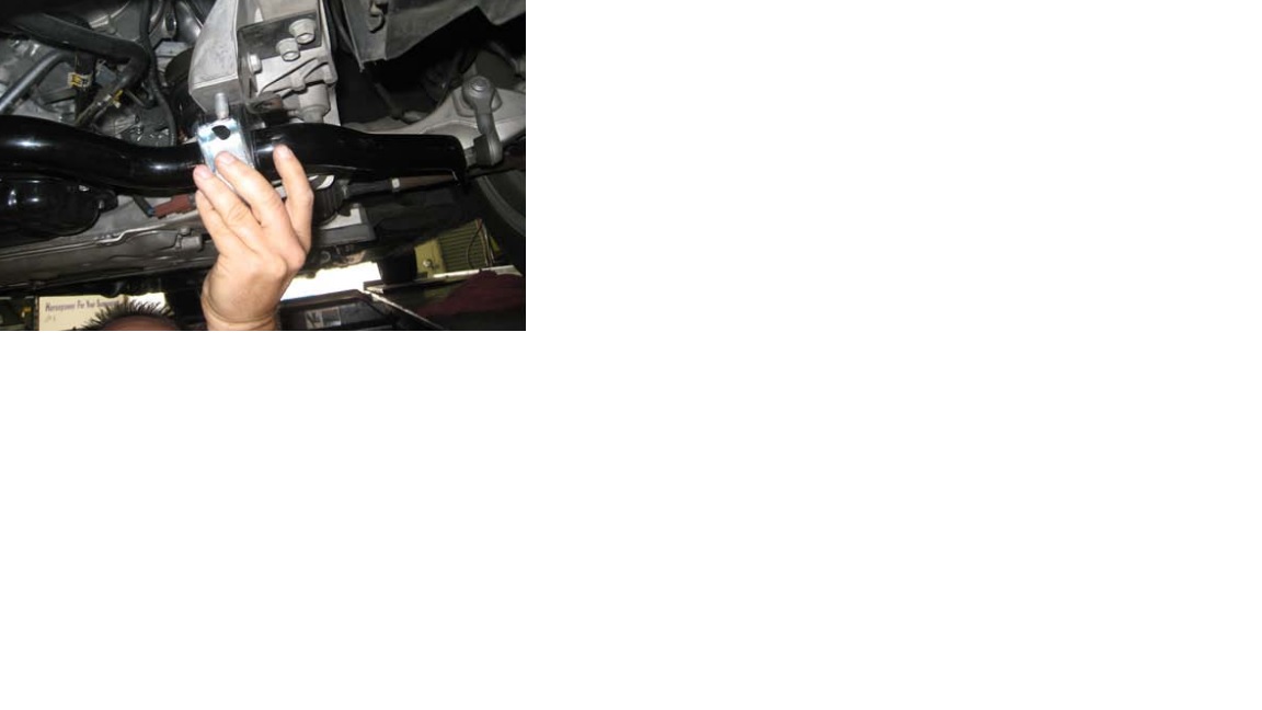

I think that's a pic of the bolt fully removed. All we see from the bottom of the car is the bolt (sans head) protruding from it's spot on the chassis.
Is that correct daicon?
