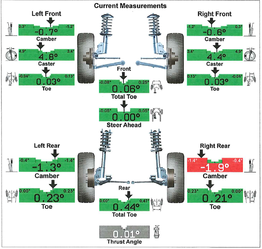

Posts: 184
thanks, I'm happy with it, happier still every time I see another g37 at stock ride height
the passenger rear camber had to be set at 1.9 to get the toe in spec, since the toe bolt was seized on that side
My bad, I forgot about your toe bolt issue, looking perfect otherwise.
