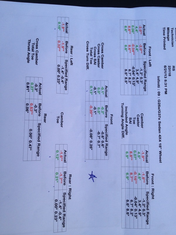

After 3hrs of waiting & $220 in my pocket.
No camber kit whatsoever.
What u guys think?

A bit high on the alignment charge (mine was about $120 and they had to adjust all the new arms & toe) but you'll be fine w/ those readings
