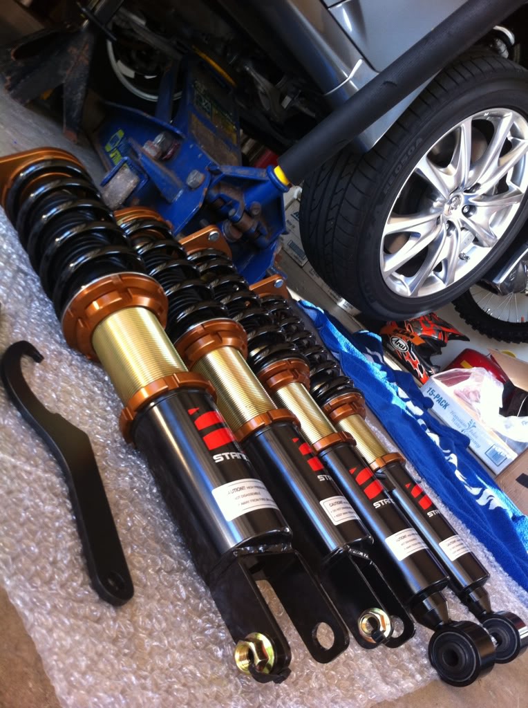

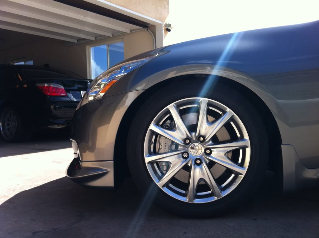

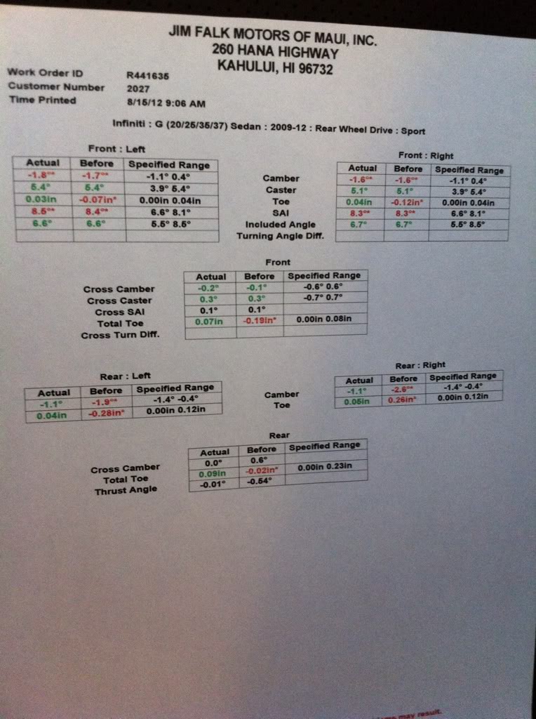

So I just installed my Stance GR+ coilovers (true non OEM type) & I have to say, I LOVE THEM! I don't know why more people aren't going with this setup as it is a very well built & pretty cheap setup. Anyways, on with the review. Install was a breeze & pretty straight forward. My only dislikes were that the mounting "stud" for the front brake line wasn't able to thread on the nut due to the heavy coat of black paint on the threads. I just used zip ties to hole it in place. Also if you're worrying about adjusting the dampening, you will need extenders for the rear (stance offers them as an add on) & drill a hole for them. Or deal with the fact that you have to remove the rear coilovers to make dampening adjustments. I set my ride height all around to 26 5/8" from the ground up. Dampening set at 6 clicks from full soft. I only went with the SPC rear camber/toe kit for alignment, which was a bitch to grind out the eccentric bolt holes lol. Took it today for an alignment & got everything (except front camber) dialed in. The ride is slightly stiffer than stock. Feels like it should've came like that from the factory. No rubbing when turning, going over dips, speed bumps, etc. I would highly recommend this setup to anyone who is looking into upgrading their suspension. I'm sure there are many better options, but you can't go wrong with these. Here's some pics, ENJOY!
