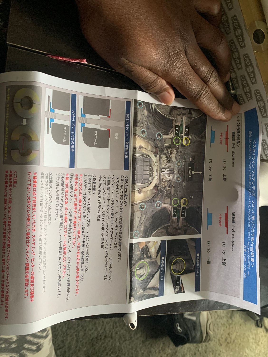

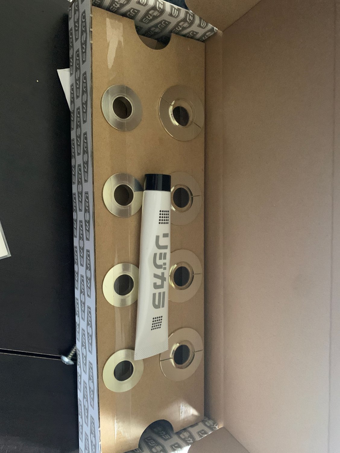

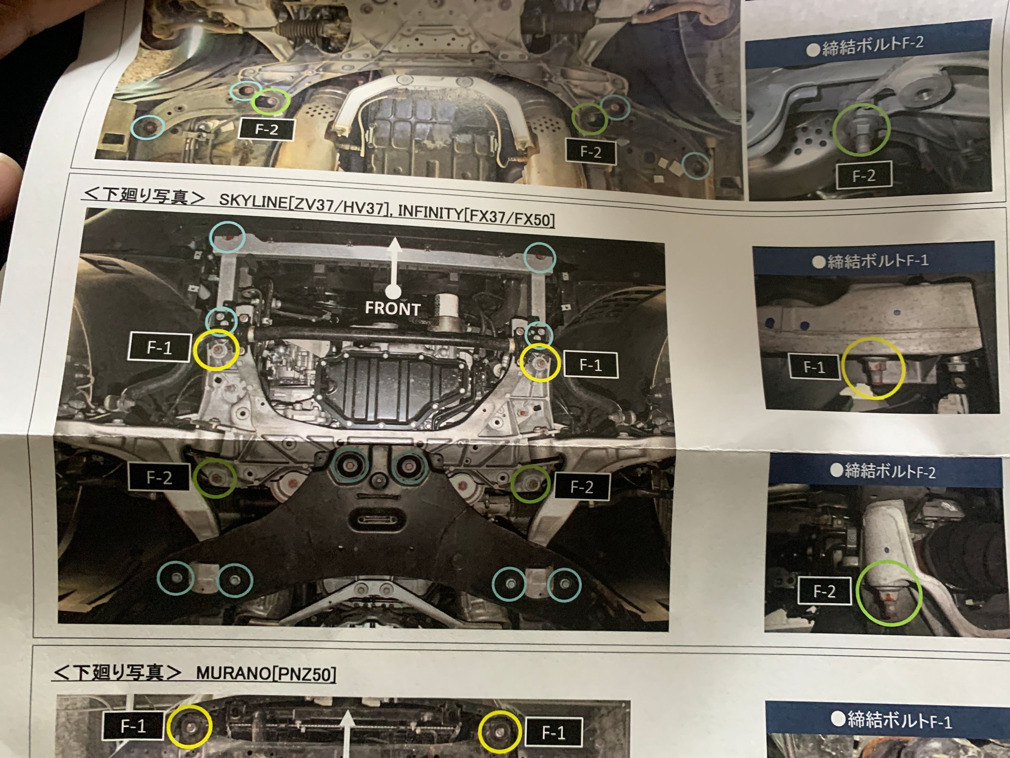

How to install spoon ridgid collars
Im looking for help with installing spoon sport ridgid collars on my g37 coupe. If anyone has or can point me in the right direction that would be nice.

Download google translate app to scan the instructions and it will translate them. Here's a sample of the instructions you posted.
Dedicated bolt-2 The following work or removal work is required as necessary Front tire/under cover/side cover etc.
Gazette plate and bolt (blue circle)/lower arm bar/support bar various wiring Steering universal joint bolts (red circles) such as connectors and clamps, hose stay bolts and levelers, and other procedures for attaching and detaching required parts
2 Apply the attached grease to the Rigikara and insert it into each joint with reference to the cross-sectional view *Rigikara (1) is a split type.
Divide it in two and attach it by sandwiching the bolts from the left and right. *For safety, please work one place at a time.
3 Temporarily tighten the fastening bolts little by little while maintaining the flat frame town of the subframe to some extent. *To prevent snagging, do not use an air tool to tighten the bolts.
4 Make sure that all the fastening parts are fully raised, and then tighten the port with the manufacturer's specified torque.
5 Attach the removed name.> About the attached Rigikara grease> The included grease is used to keep it clean. Please sew it to the lantern and lincan.
*Please be sure to make a test run after installing and check and adjust the steering center. If a large deviation occurs, we recommend adjusting the alignment.
