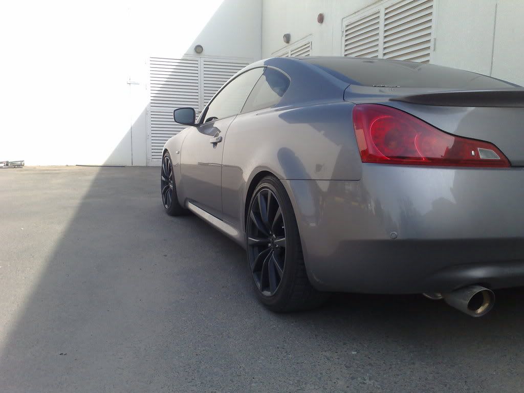

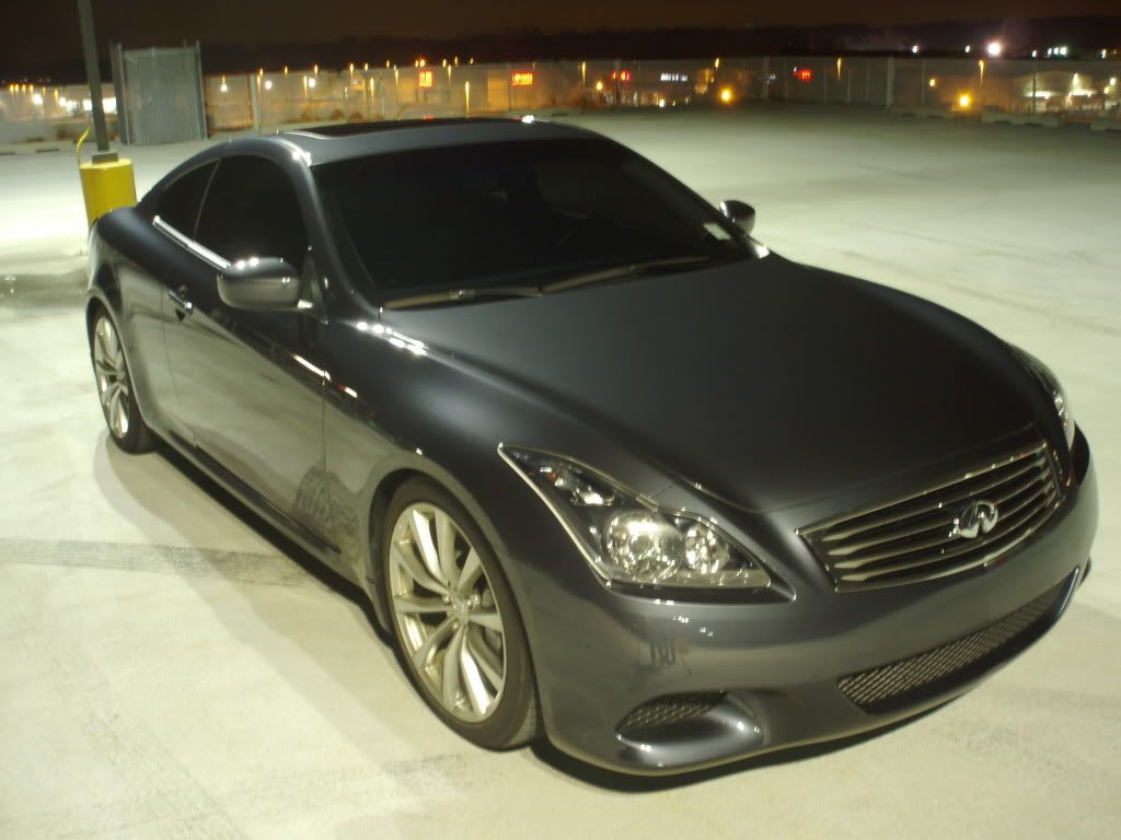

I just stole some pictures from this forum to show you.... here is the car stock:
There is a distance of maybe 20-25mm from the edge of the wheel to the inside edge of the front fender. Its hard to notice when its stock.
But as you lower it......
So thats why people tend to look to spacers to push the wheels out after dropping the car because the "tucked-in" look becomes more apparent as you drop the car.
Spacers push the wheel out 10, 15, 20, or 25 mm and make the stock wheels look a little more flush with the fenders and the side of the car and get rid of the "tucked-in" look.
As you drop the car more, the more "tucked-in" it looks. The tanabes are a very mild drop and still have a very small fender gap, so the "tucked-in" look is less noticeable than what you have on Eibachs, or other springs which drop more in the front.
But this is just all personal preference.
Thanks for the info! That blue slate G, is that drop without any spacers by the way? From the looks and pictures and all, it looks like on Tanabe on the front gives the look like 5mm more out, rather then putting in eibach front. I was trying to see and search how many people have that setup vs eibach all around? I'm leaning more to eibach all around. I was reading some website about dampers etc. and it mention if the eibach rates or any springs are greather than 10% of the original springs, this can shorten your dampers in the long term. Is there any info the S springs specs as I can see there is info the Eibach Spring specs? ? ? ? ? ? ? ?
