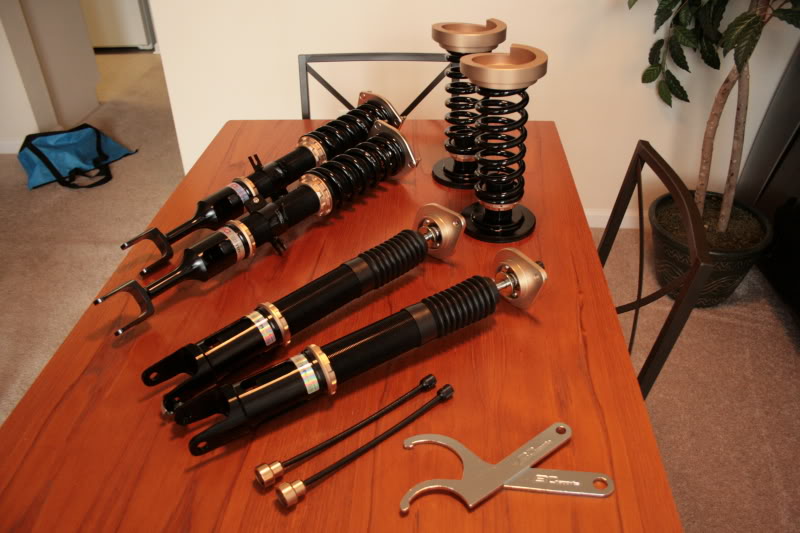

How come we didnt get this circled piece with our kits? That might help.
That will also help me raise the car a bit, because the rubber piece on the bottom is so thin, these springs are meant to be put on this, not the stock rubber piece I think.
And they look like they would fit fine if you look in this picture, they are not flat on the bottom, they are shaped just like the rubber piece.

Where'd those pics come from? Look like a G/Z set up to me!

Symalik, where did you find that? Who's dining room table is that?
https://www.myg37.com/forums/showthr...t=bc+coilovers
(first page post#1)
those springs look cylindrical and the ones we got were tapered if I remember correctly...
yea these are the BC coilovers for 350z, got the pics from mdracers 350z install page.
http://www.my350z.com/forum/showthre...ight=bc+racing
they do look cylindrical, maybe thats why... but the bottom rubber piece is so thin, the highest setting on these coilover's is still too low I feel like on the rears.
The rear perches on the 350Z look identical to the G37, so I wonder if this would help stablize the rear spring? In fact, the rear suspension components on the G37 are nearly identical to the 350z/G35. Looks like it would add some needed stability to the top spring location.
