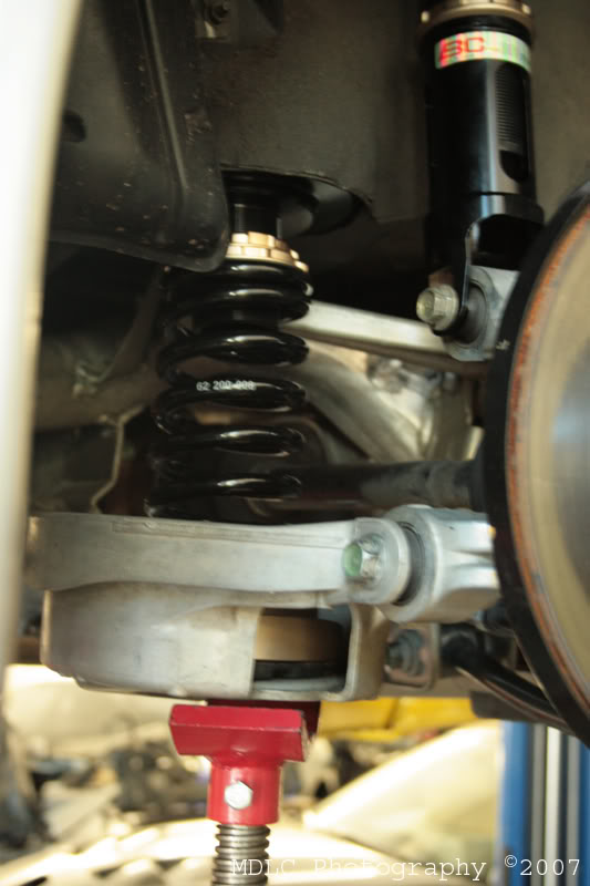

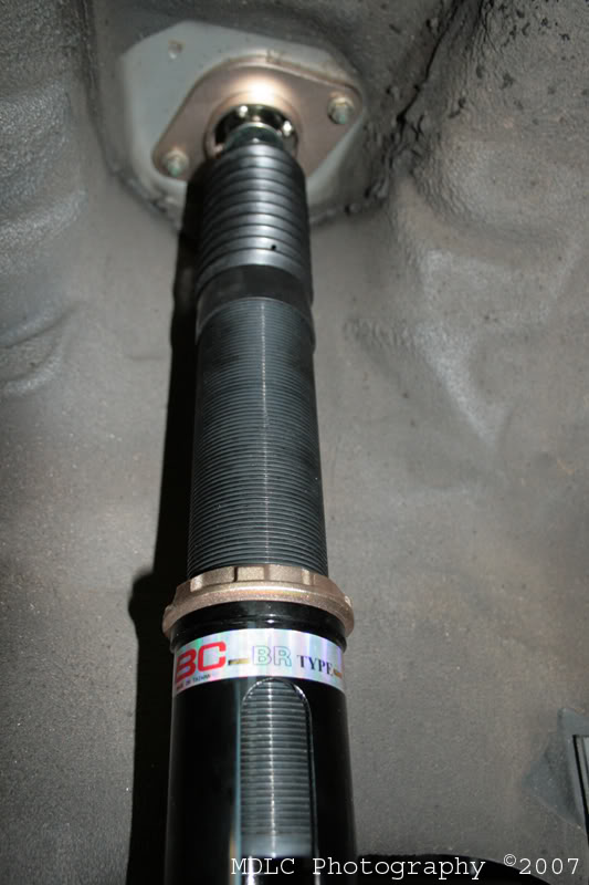

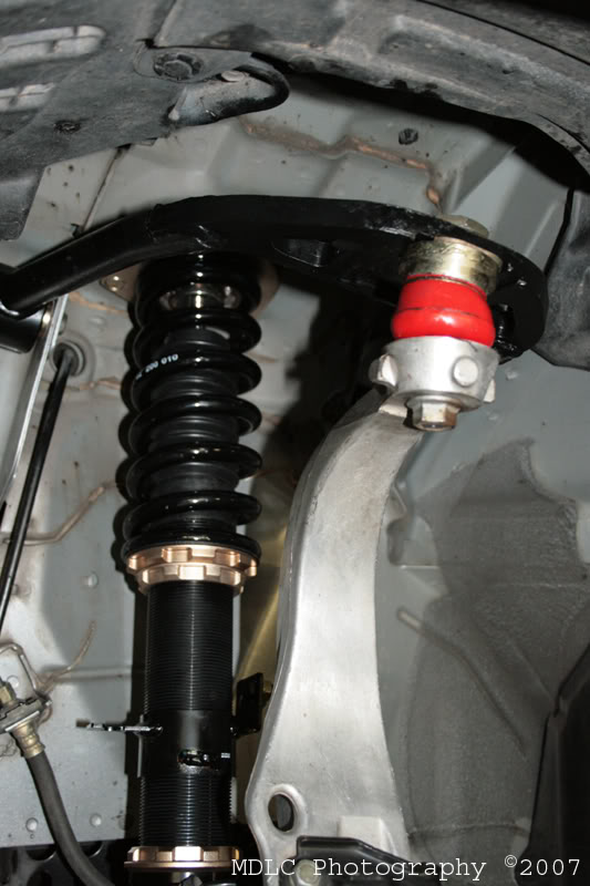

some pertinent images from my install:
hope these help!
