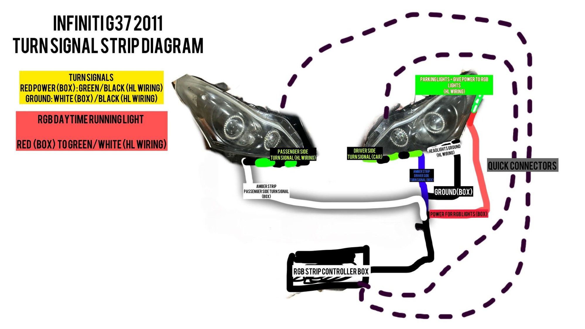

Infiniti G37 turn signal strip DIY diagram
I made my own custom headlights and did the wiring. I am wondering if I should change the red power(box) to my fuse block. The reason I am doing so is because I do not like that the preset of the DRLS is White. The preset is RGB rainbow As soon as it gets power. I am not trying to go back-and-forth, switching the color to white with the remote. So connecting it to the fuse block Makes the most sense to me. Now my question is, should I change the ground point as well or leave it where it is.
I made my own custom headlights and did the wiring. I am wondering if I should change the red power(box) to my fuse block. The reason I am doing so is because I do not like that the preset of the DRLS is White. The preset is RGB rainbow As soon as it gets power. I am not trying to go back-and-forth, switching the color to white with the remote. So connecting it to the fuse block Makes the most sense to me. Now my question is, should I change the ground point as well or leave it where it is. I can also move it to the fuse block.
