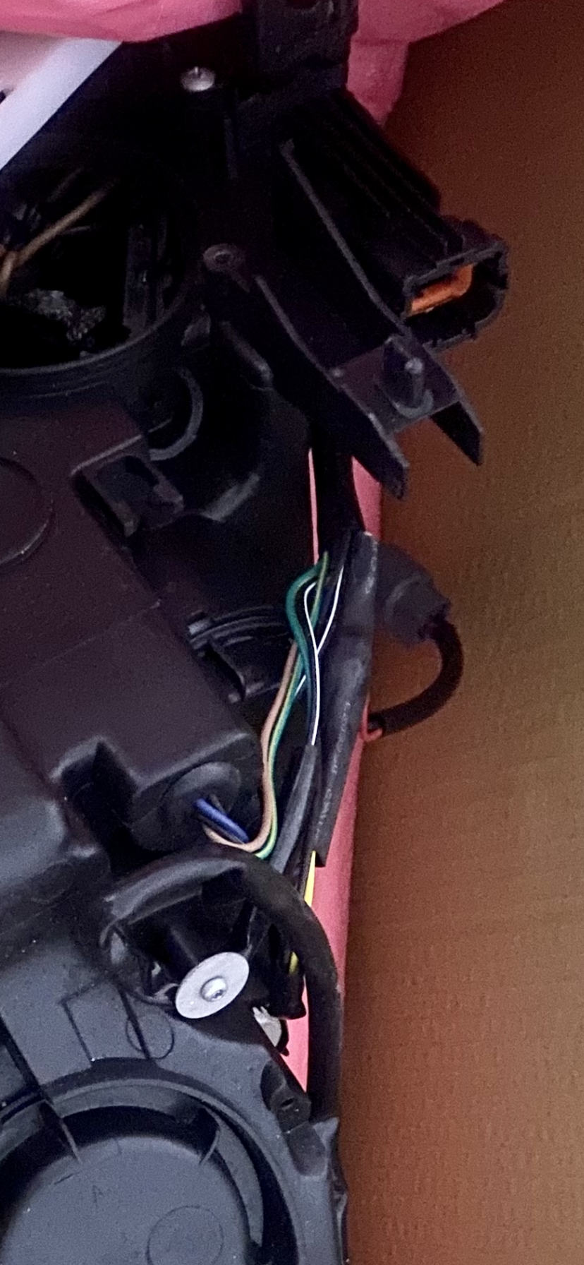

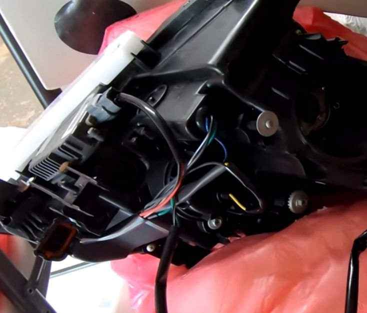

Hi I have the same headlights and iam trying to tap into the led strip so I can run my emblem to the DRL strip. I originally tapped into the red wire o the connector but unfortunately the emblem only turns on when the entire light is on.
do you know by any chance which wire on the headlight side powers the led strip? And they color please Thank you

Assuming the LED strip you are referring to is the DRL light, based on the diagram provided by member John Baggins, it seems you should have tapped into the PINK wire (passenger-side), NOT the RED wire.

The issue is I don’t see a pink wire.The only wire that looks like is positive is red. So Iam now confused because how is the DRL strip getting power when the main bulbs are turned off. There has to be a separate wire that powers the led strip,I just can’t figure it out.anyone that has an idea please help I would appreciate it.

What side are you looking at? Driver or Passenger?
What year/ model is your car, specifically?

Driver side

Is there a ORANGE wire? Again, based off the above diagram.
Again, what YEAR/MODEL is your car? This makes a big difference when comparing the OEM wiring diagrams...

I have a 2015 q60s (g37 body) and no I dont see a orange wire. Just so there is no confusion I taped into the connector on the headlight side not the Connector on the harness.
