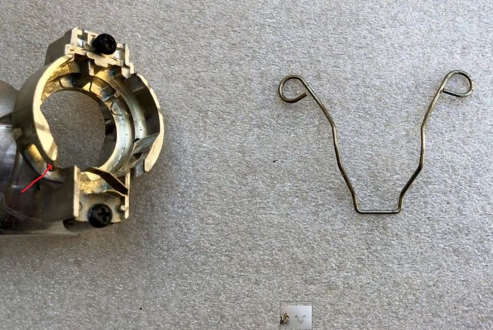

Hi guys, so i'm having a problem with my headlight bulb where i broke off both sides of the bulb holder, so the spring doesn't solidly hold down. Thus the bulb is wobly and flickers while driving. I thought it was a bad bulb, but replaced it today and broke off one of the side plastic pieces. I had previously broken off the other side 2 years ago.
Anyone know a fix for this issue / or where I can buy a new bulb holder? The picture i attached is from an old ebay listing, but shows what I need to replace.

Hard for me to tell from the picture, can you take a more up close picture to the 'broken' piece? It doesn't look broken to me. Looks like the retainer spring can still lock into place.
Took the replacement light out today to try and fix the wobble, part of the plastic on the end of the light was melted, as well as some inside of the ballast. I'm hopping it just sparked and caused that because it bounced when i drove it at night for 15 mins. Cross your fingers there isn't some electrical short somewhere.
The picture didn't have a broken piece, it was a generic picture showing the part. The arrow was pointing the the pieces that are broken off on each side, so the springs don't lock down. I was able to fix (hopefully) the problem by using a zip tie to hold down the springs. The zip ties are wrapped around the little nub at the bottom of the projector, being pulled so the springs go down towards the front of the car.
