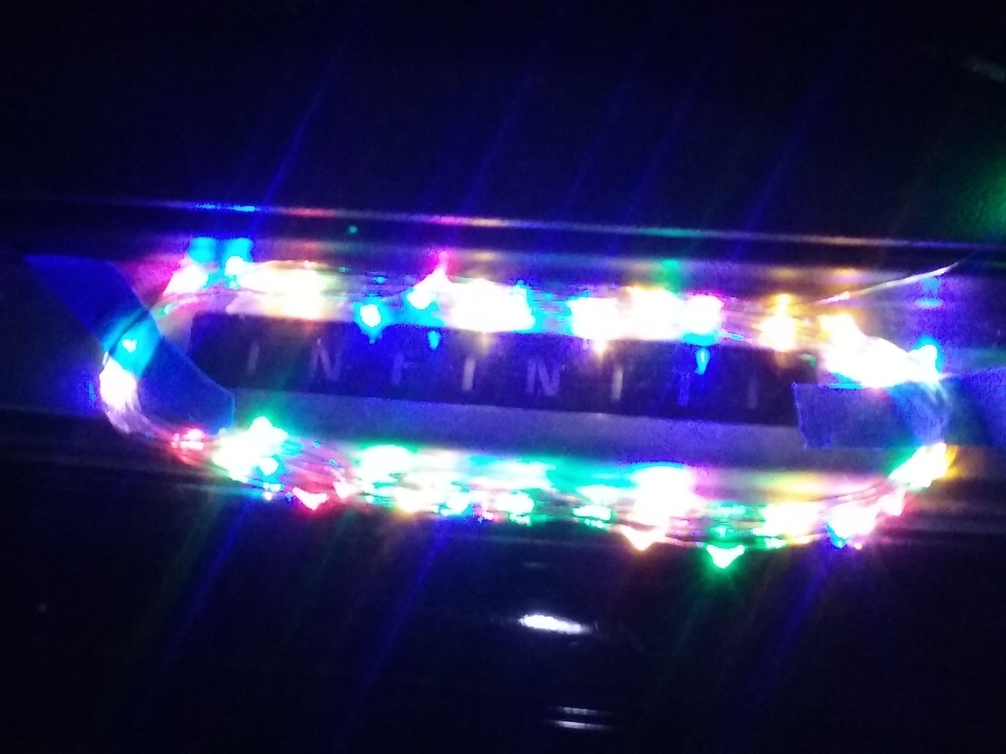

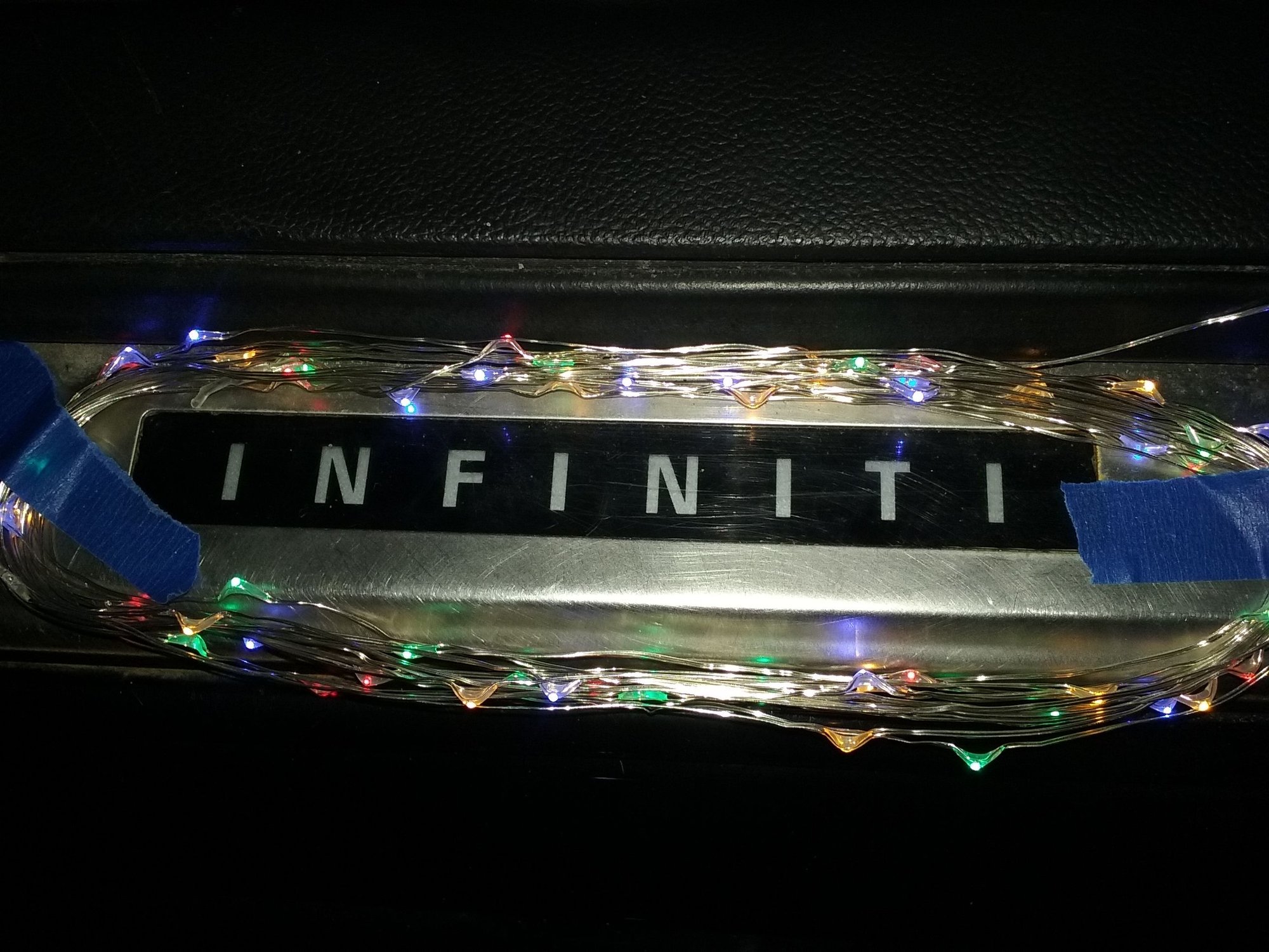

Good thinking on the meter workaround. I knew I kept that 10yr old spool of thermostat wire around for a reason. Tested off the battery, the sill is dead. I'm still going to check that power is making it down to the harness before buying a unit once I see a friend who has a meter. It'll give me time to set cash aside.
In the meantime I went with a custom rig. It's pretty freakin' sweet. If ya'll get super jealous I suppose I could put some kits together and throw them on ebay for a couple hundred. Lemme know...
