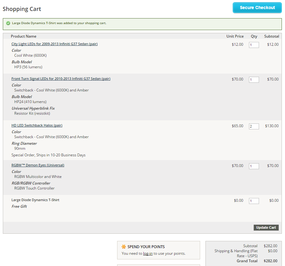

Alright guys, I have my order ready to place, I think I'm going to do it myself. This is my order list.
So currently, as I'm in Canada, my DRL consist of low beam, city light, and turn signal all on, with the latter 2 as amber. My low beam setting is identical. My auto-night setting is identical but with fog lights on.
The plan is:
DRL: just 2 halos on, white. Possibly demon eye set to white or ice blue as well.
Low beam: turn signal to white (switchback LEDs), and HID on. Halos on? If not overpowered.
Night mode: City light (white) on, turn signal (white) on, HID on, fog lights on. Possibly halos if not overpowered.
Turn signal: 2 switchback halos on, amber, flashing. Turn signal light amber, flashing. Condition same regardless of setting.
Housing: Delete side reflector, matte/satin black paint for housing, keep projector shroud chrome. Is the "cap" on the turn signal and the cover on the city lights amber? I can't remember off the top of my head.
Eventual additions: HID and fog lights converted to 6000K to match remaining lighting.
How does this sound guys?

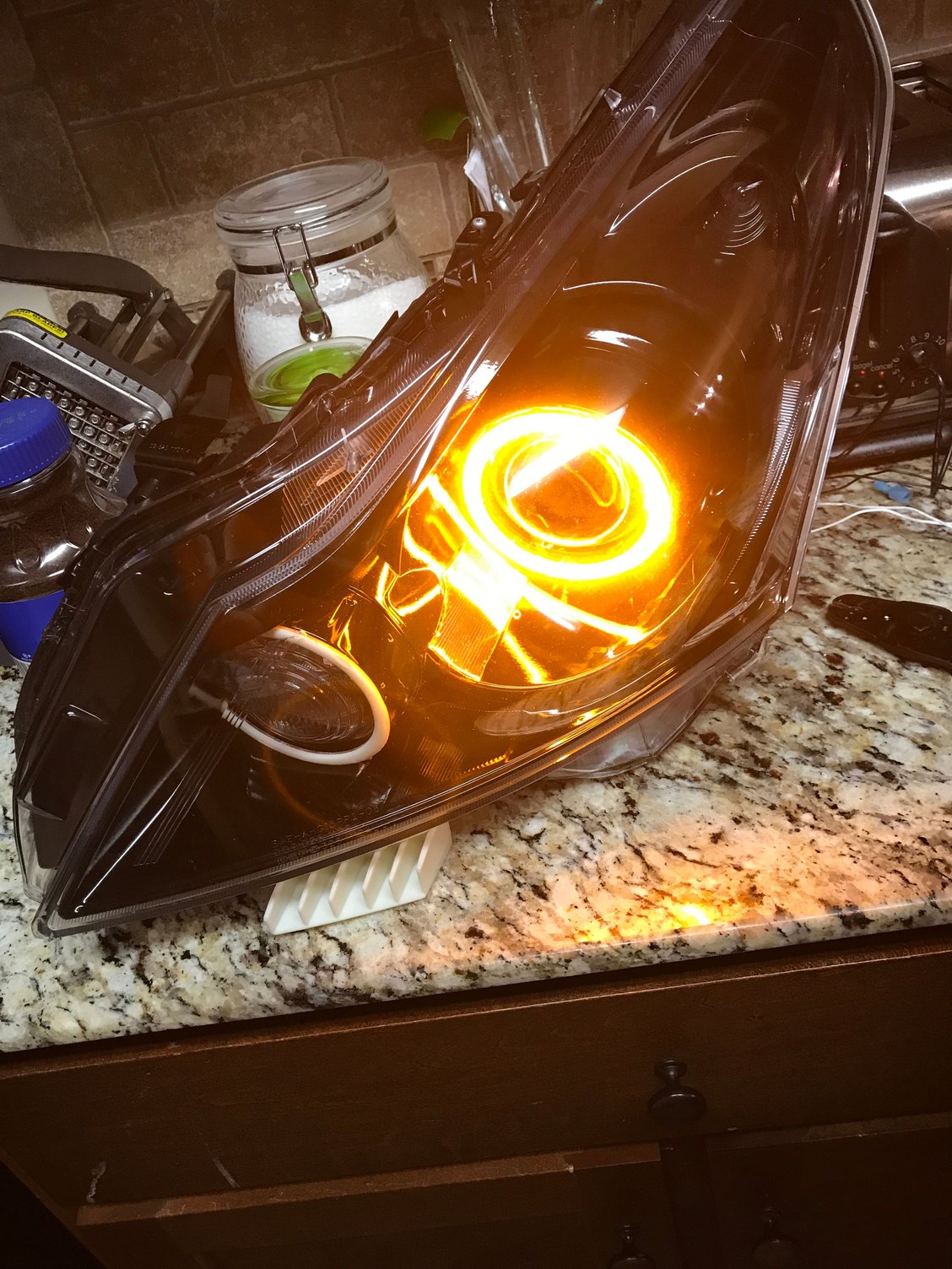

Here's my headlight set-up.

Jesus Christ that looks good, is that just a second projector?

Originally Posted by zaz
Ah darn. So the bubbling is inevitable? I was going to leave that little ribbed chrome bit alone anyways. I live in Canada btw, if that helps. Would it be worth it to put ceramic tints or something of that sort that doesn't darken the lens but reduces heat flowing into the lens?
If you leave those spots in front of the projectors untouched then you shouldn't have an issues. My car is 8 years old and the chrome on the headlights still looks brand new, and I'm out in the desert in SoCal where its Sunny 330 days a year.
Thanks, man! Much appreciated! It's basically a dummy projector... so a real projector lens, but without the projector housing. I'm using the OEM fitment V3 Triton switchback LED bulbs. So the inner "projectors" light up with my main headlights but flash amber when the turn-signals (or hazards) are used.

Did you do your own, and delete the amber reflector?
