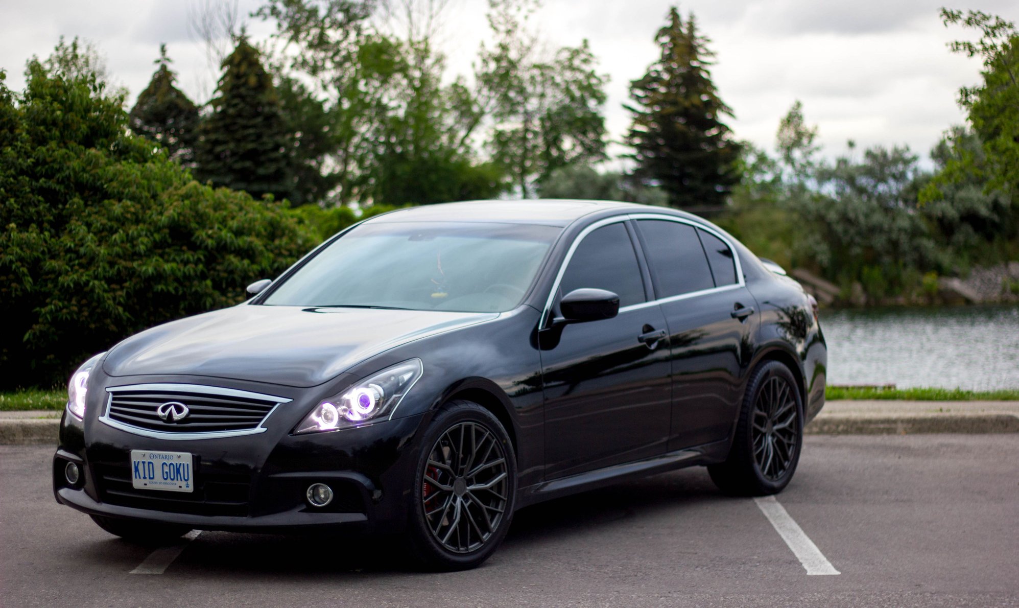

So I'm finally done. I ended up having a shop put all the parts in to save me the headache. So what he did was, since my fogs come on auto with night mode, he put a relay in so my DRLs are my halos and when the fogs come on, everything does. However, as high beams turn fogs off, he has to fix that as currently I have no high beams. See attached for a picture of what the car looks like right now! All I have left for this year is springs, maybe lip/exhaust. But most likely I'll do the latter next year unless a really good deal pops up. Swift springs for sure though.

That is a gorgeous car right there. By any chance do you remember what site you bought those halo rings? I'm looking to buy some exactly like those.

Hey man, not the guy you responded to but the two most popular rings on the market are the diode dynamics and morimoto ones. Both are fantastic. I've heard from others' anecdotal experience that morimoto has a better "amber" if you wanted to run those as DRL but diode dynamics has a brighter white? But of course I don't know how valid that is.
I got the diode dynamics ones and they have been fantastic. Went with them because I was using white as DRL and it is pretty damn bright. Customer support has been great as well, for these and all other parts I've gotten from them. Both brands are pretty equivalent as far as price goes and you can't go wrong with either.

Wow, yeah those are beauties. If it's not too much trouble, can you send me a link to the Diode Dynamics? I can't find them for the g37 sedan to save my life. And any other brand like Ledconcepts or NFCperformance only sell the main two rings and not the 4 like in those pictures. Thanks for the info by the way!

I used 90mm on all 4 halos, just know you have to trim the turn signal housing for the halo to fit.
