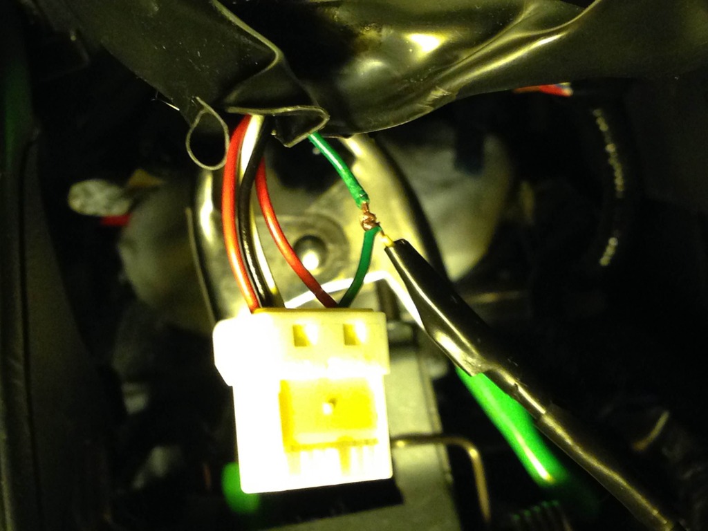

I have installed a backup camera on my coupe. I tapped it into the RCA harness so you hit aux when you want the back up camera to turn on.

Wasn't too bad. Splicing into the back up camera wiring is pretty bad, the wiring is very small and doesn't have length, I need to have someone solder mine correctly at some point. So you need to lift the entire center console, there is a harness under there that connects into the back of the RCA thing. You just splice the RCA cable right into the video cable on the harness. Picture attached. Then wire up the back up camera to whatever power source. I just used the reverse lights. Ran the wire from under the front seat then into the small plastic panels by the door, runs all the way back up to trunk and through the oem harness holder and up onto the spoiler. Not all that bad.
