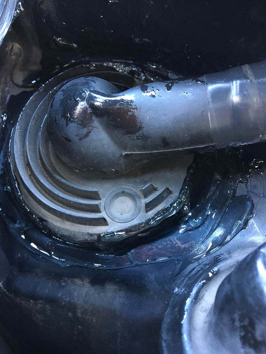

I think your best bet would be silicone from home depot. It work for me, put on some gloves on and paste the silicone all around the grommet like i did. It looked messy but in the end nobody's going to look at it, its not visible and does the job. Thanks
Hope this helps
Hope this helps
Attachment 128392
I did the same tbing. I have a feeling water gets in through filter though?
Hope this helps
Attachment 128392
How easy is it to access this gromet? By chance, do you have any general steps on accessing this area?
I have a slight leak on my passenger side leaking to my mat.
Under battery cover. Behind battery

I guess I spoke too soon - this past Saturday's rain here in the northeast caused some leaks. back to square one.
