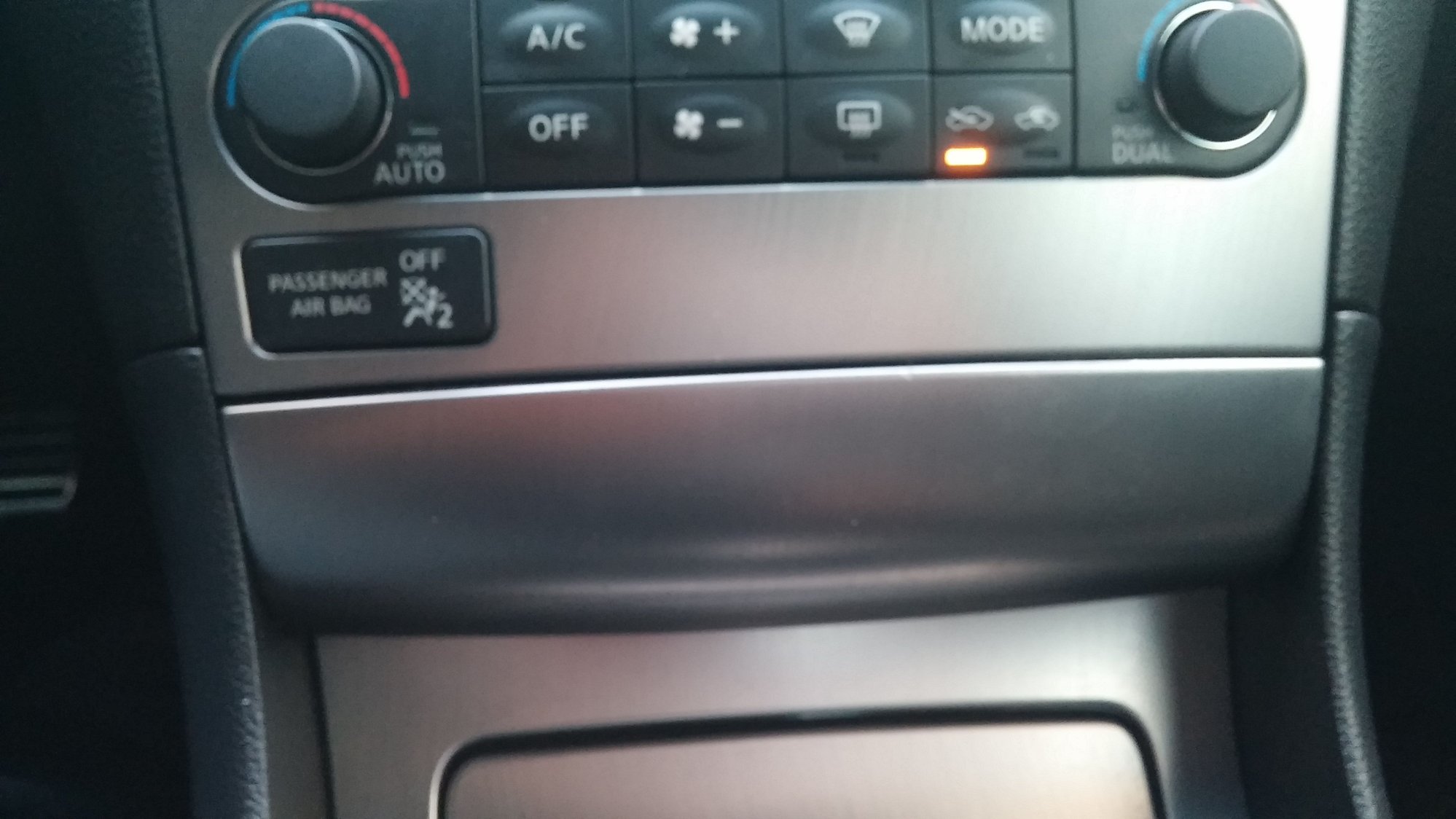

Trim issues
I know to some this is probably not a big deal, but it's been driving my crazy. How does this piece of trim attach? It's lower on the driver side than the passenger side. Anyone have this issue, or know how I can fix it?

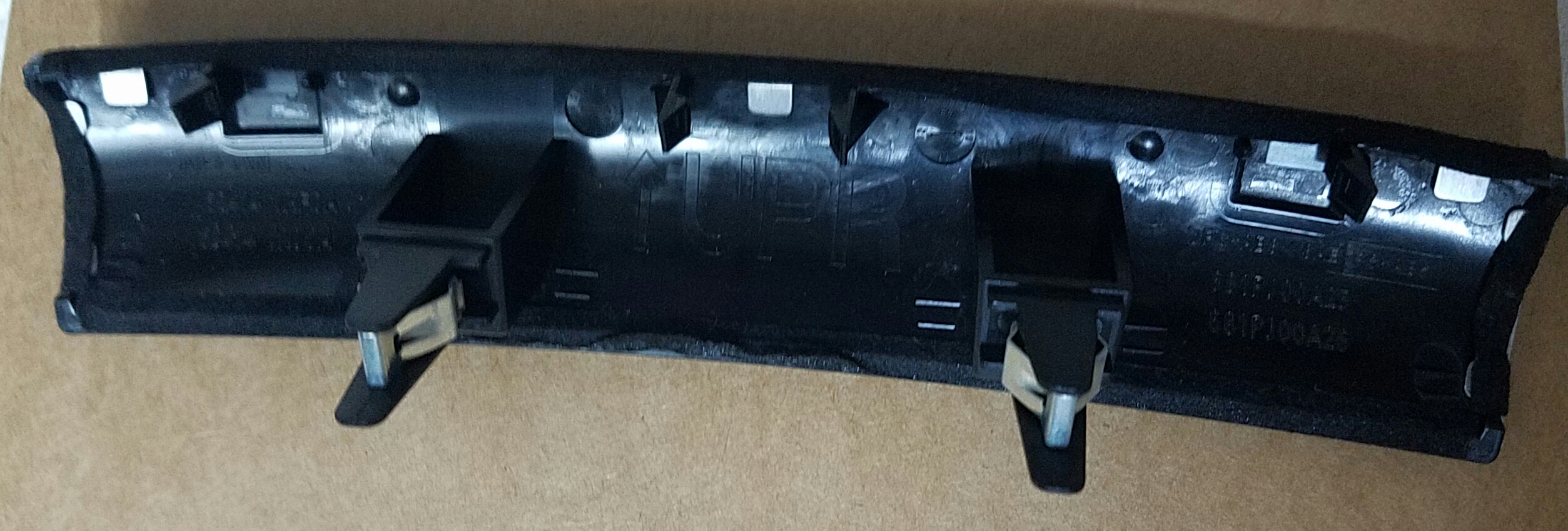

There are 2 large metal clips and 1 smaller plastic retaining clip (top, middle). The trim just pushes into the center console and gets locked into place. It's attached pretty darn tight. Just be very careful if you try to remove the trim piece, it can get scratched really easy- trust me, I had to replace it once already.
Hope some of this helps.
Old Oct 16, 2016 | 09:36 PM
TwistedIllusion's Avatar
TwistedIllusion
Joined: Sep 2016
Posts: 82
Excellent. Thanks for the tip, I'll try messing with it tomorrow. I'm guessing one of the clips must be bent or something causing it to sit lower on one side.
