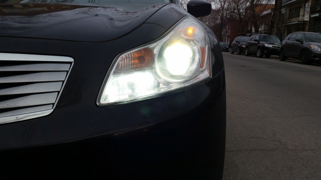

Hi, Last year I bought LED from Diode Dynamics to replace the originals drl/fog on my 2009 xS. I'm not sure if it supposed to be called Fog or drl but those ones (bottom left) Name:  20150416_184216_zpsmn6jc1x7.jpg

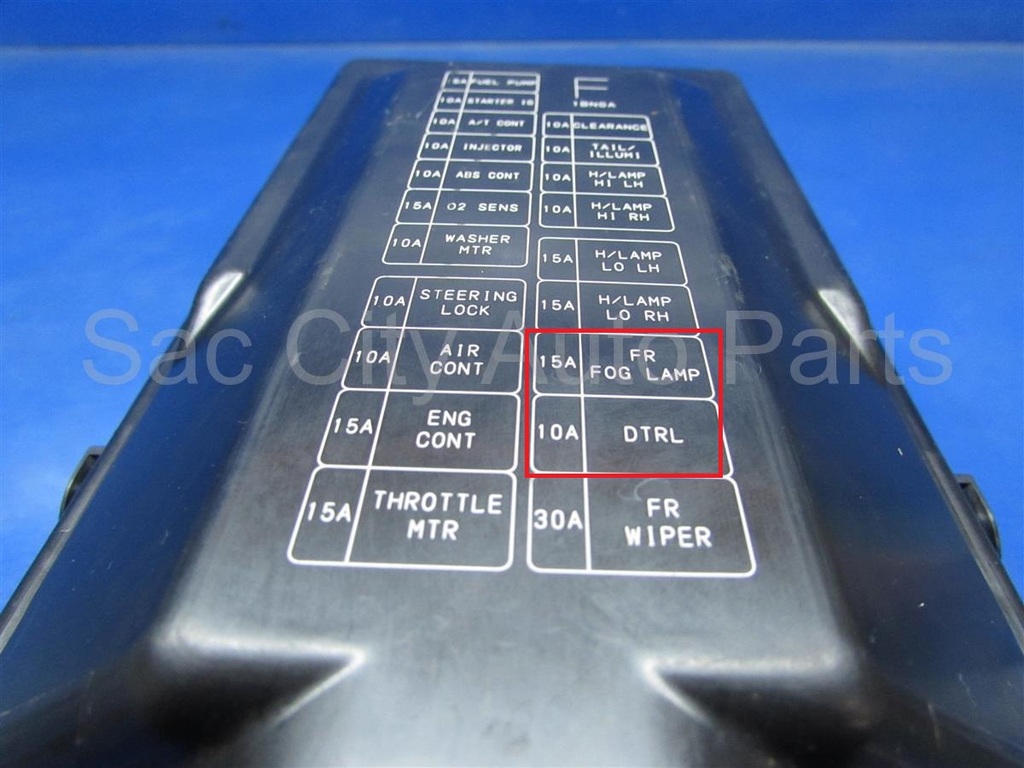

I took a google image to show wich fuse I did change.
According to your message I would also have another one from this box to look at ? And can you also tell me wich ones from the cabin are 50, 51 and 58 please ? And while I was trying to google where the fog lamp relay is, I found this diagnostic procedure.

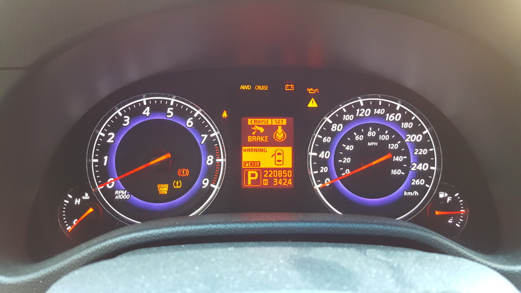

It did work, I had the horn noise and the wiper started by themself but I don't exactly know what I was supose to expect out of this I just filmed the dash in case it gives a message or whatever, but after 5 minutes still nothing exept those lights on :
Does it show something helpfull ?
