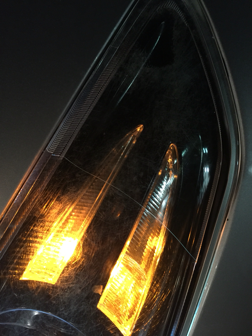

Does anyone know the name of the Amber side bulbs on the headlights (2011 g37 sedan) pic attached. Looking into getting rid of the Amber are they called side marker lights? Old pic by the way. Also wondering if I can get them at a auto parts store?currently going to install headlights so can't wait for shipping

I believe you're correct. They are side markers. I replaced mine with LED. A lot brighter and cleaner.

I had the opportunity to order them with the order of diode dynamics but I mistakes then for city lights thanks I will see if I can get some at auto zone hopefully I want to get it white no Amber

Did you change them to white?

Thanks for your help I bought some cool white sylvania led 194 for them should work!

Yup. Those are the right ones.
If they don't work the first time just take them out and reverse them. Sometime they're picky about the polarity.
I went in through the fender cover because my hand is too big to fit down through the top.
