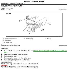

Download the FSM, it's stickied in the sedan main page. Here's the directions from the WW section page 86.

Wow. You're awesome. Thanks for that!
