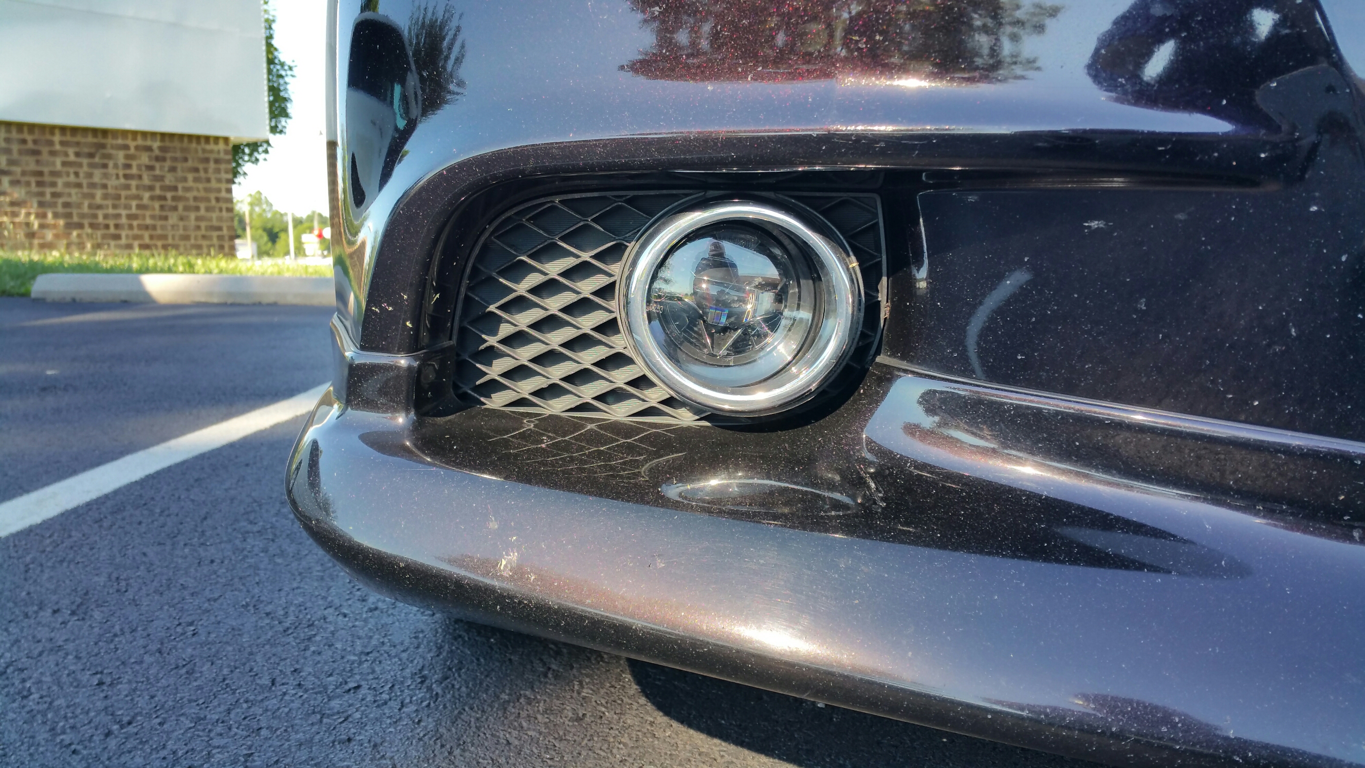

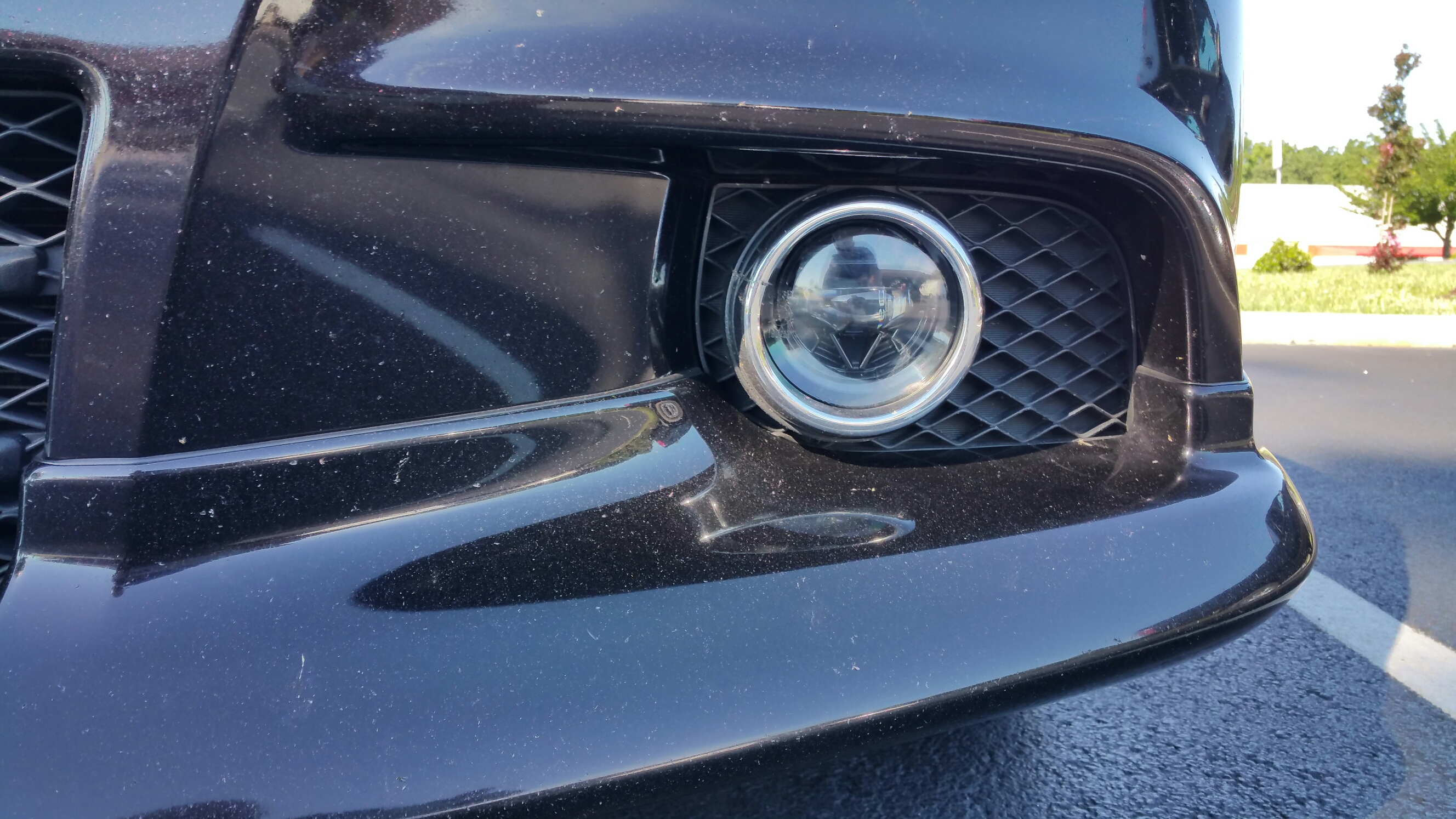

Here's another observation that no one mentioned: the rectangular reflector component inside the fog assembly is clearly visible in the way the light emits from the unit, and that's fine. However the way the assembly is fitted to the bumper means that this rectangular image is about 5* to 10* off-level, and not perpendicular to the car. It's a pretty minor observation, but still... once you see it, you can't un-see it.
This is a picture of my driver and passenger 2nd gen fog lights. The drivers side is perfectly flat but the passenger side is off by at least 10*. Thankfully it's higher on the right side of the road so it highlights more of the trees but it's still a noticeable difference. Because of how hot and wet it's been, and how complicated it is to access the passenger side light, I haven't tried to readjust it.
